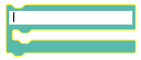

if [                           ] :: custom-switch
end
Select the open space of the block indicated in the image here and begin typing.
C Block diagram illustrating the open space for inputting Switch Python commands for looping conditions.
