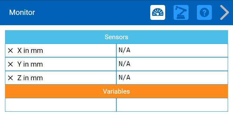

It is possible to monitor the values of sensors and variables within VEXcode using the Monitor Console.
An image of the Monitoring Console found within VEXcode CTE, showing the monitored values for x, y, and z in millimeters.
By default, the x, y, and z positions of the 6-Axis Arm are reported in the Monitor Console, but you can add other sensors and variables using the two commands below:
