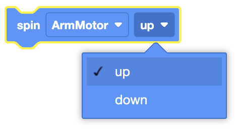

The Arm Motor can spin in the up or down directions.
The image shows a coding block from a visual programming interface, where the user is selecting the direction for a "spin" command. The selected motor is "ArmMotor," and the direction is set to "up," with an option to switch to "down" in the dropdown menu.

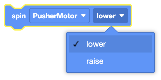

The Pusher Motor can spin in the lower or raise directions.
The image displays a visual coding block where the "spin" command is applied to the "PusherMotor." The direction for the spin is currently set to "lower," with an option in the dropdown menu to switch to "raise."

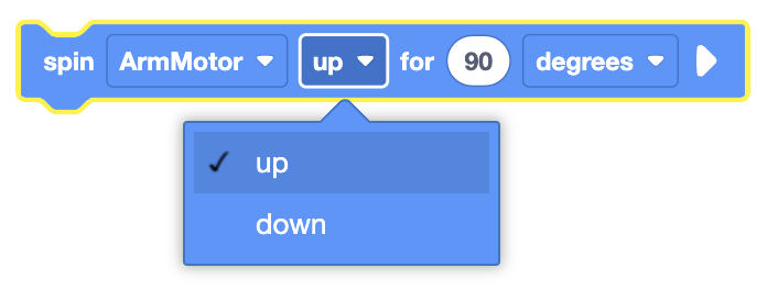

Select which direction for the motor to move in.
The image shows a visual coding block that is used to control a motor. In this block, the "ArmMotor" is selected, and the direction is set to "up" from a dropdown menu. The block specifies that the motor will spin "up" for "90 degrees." The dropdown menu is visible, offering the option to select "down" instead of "up."

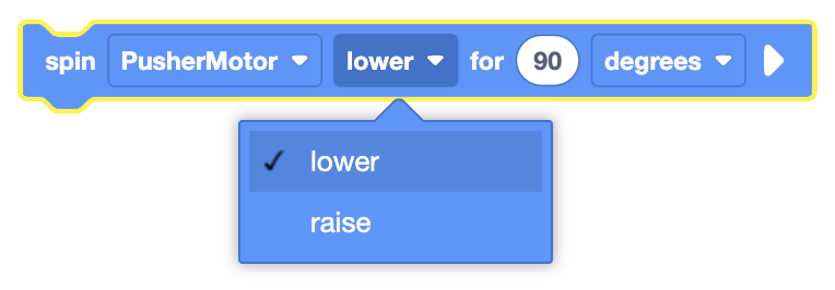

The image shows a coding block that controls a motor labeled "PusherMotor." The block specifies that the motor should spin in the "lower" direction for 90 degrees. A dropdown menu is visible, allowing the user to select "lower" or "raise" as the direction.

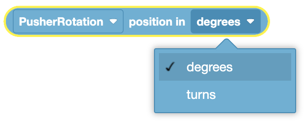

Rotation Position#
The Rotation Position block is used to report the Pusher Motor’s current position.
([PusherRotation v] posición en [grados v] :: custom-sensing)
Select which unit to report in, degrees or turns.
The image displays a coding block where the "PusherRotation" component's position can be checked in either "degrees" or "turns." The dropdown menu is currently set to "degrees," but it also offers the option to switch to "turns" as a unit of measurement.

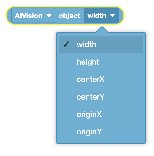

AI Vision Object#
The AI Vision Object block will report information about an AI Classification from the last use of the Take Snapshot block.
([AIVision v] objeto [amplitud v])
Choose what property to report about the AI Classification:
  • width: How wide the AI Classification is in pixels.
  • height: How tall the AI Classification is in pixels.
  • centerX: The X coordinate at the exact center of the AI Classification.
  • centerY: The Y coordinate at the exact center of the AI Classification.
  • originX: The X coordinate at the top-left corner of the AI Classification.
  • originY: The Y coordinate at the top-left corner of the AI Classification.
The image shows a set of rounded blue buttons labeled "AIVision," "object," and "width" aligned horizontally at the top. Below the "width" button, a dropdown menu is expanded, displaying a list of options that includes "width" (which is selected), "height," "centerX," "centerY," "originX," and "originY."
