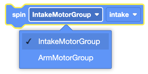

girar [IntakeMotorGroup v] [consumo v]
Select which motor to use.
Diagram of a spin motor block used in VEXcode VR for controlling motor movements in robotics.
Select which direction for the motor to move in.
spin_direction

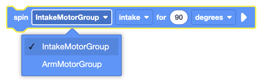

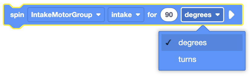

Spin for#
The Spin for block is used to spin a motor for a given distance.
This is can be a non-waiting or waiting block depending on if the and don’t wait option is used.
girar [IntakeMotorGroup v] [consumo v] por [90] [grados v] ▶
Diagram illustrating the Spin for block in VEXcode VR for motor control in robotics programming.
spin_for_direction
Set how far the motor will spin by entering a value, and choosing the unit of measurement (degrees or turns).
spin_for_unit
By default, the Spin for block will block any subsequent blocks from executing until it’s finished. By expanding the Spin for block to show and don’t wait, blocks will continue to execute while the motor is moving.
girar [IntakeMotorGroup v] [consumo v] por [90] [grados v] ◀ y no esperes
In this example, the intake motors will spin in the intake direction for 1 turn.

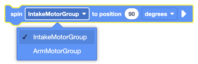

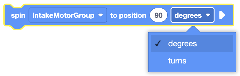

Spin to position#
The Spin to position block is used to spin a motor to a set position.
girar [IntakeMotorGroup v] a la posición [90] [grados v] ▶
Diagram of the Spin to Position motor block for VEXcode VR, illustrating motor control parameters and functions.
spin_to_position_unit
By default, the Spin to position block will block any subsequent blocks from executing until it’s finished. By expanding the Spin to position block to show and don’t wait, blocks will continue to execute while the motor is moving.
girar [IntakeMotorGroup v] a la posición [90] [grados v] ◀ y no esperes
In this example, the motor will spin to the 270 degrees position.
cuando empezó
girar [IntakeMotorGroup v] a la posición [270] [grados v] ▶

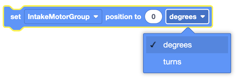

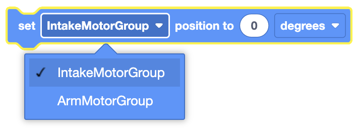

Set Motor position#
The Set Motor position block is used to set a motor’s encoder position(s) to the entered value.
This is a non-waiting block and allows any subsequent blocks to execute without delay.
Establezca la posición [IntakeMotorGroup v] en [0] [grados v]
Diagram illustrating motor position and control blocks for VEXcode VR in robot programming.
Set the unit of measurement to use, degrees or turns.
set_motor_position_unit
In this example, the Motor’s encoder position is set to 90 degrees before the motor spins to the 0 degrees position.
cuando empezó
Establezca la posición [IntakeMotorGroup v] en [90] [grados v]
girar [IntakeMotorGroup v] a la posición [0] [grados v] ▶

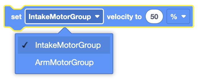

Set Motor velocity#
The Set Motor velocity block is used to set the speed of a motor.
Establezca la velocidad [IntakeMotorGroup v] en [50] [% v]
Diagram illustrating motor velocity control in VEXcode VR for robot motion tasks.
The Set Motor velocity block will accept a range of -100% to 100%.
In this example, the Motor’s velocity is set to 75% before it spins for 1 turn in the intake direction.
cuando empezó
Establezca la velocidad [IntakeMotorGroup v] en [75] [% v]
girar [IntakeMotorGroup v] [consumo v] por [1] [giros v] ▶

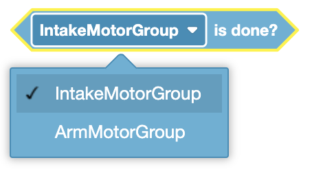

Motor is done#
The Motor is done block is used to report if the selected Motor or Motor Group has completed its movement.
<[IntakeMotorGroup v] ¿está hecho?>
Select which Motor or Motor Group to use.
VEXcode VR blocks for motor control, including Spin, Stop, Set position, and Sensing functions for robot motion.
The Motor is done block reports True when the selected Motor or Motor Group has completed its movement.
The Motor is done block reports False when the selected Motor or Motor Group has not completed its movement.
The Motor is done block is used in blocks with hexagonal (six-sided) spaces.
In this example, the Arm will be raised so the Distance Sensor can report the closest object’s distance.
cuando empezó
[Raise the Arm out of the way of the Front Distance Sensor.]
girar [ArmMotorGroup v] a la posición [1000] [grados v] ◀ y no esperes
[Wait until the Arm has finished moving.]
esperar hasta <[ArmMotorGroup v] ¿está hecho?>
[Print the distance between the Front Distance Sensor and the closest object in front of it.]
imprimir ([FrontDistance v] distancia del objeto en [mm v]) ▶

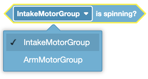

Motor is spinning#
The Motor is spinning block is used to report if the selected Motor or Motor Group is moving.
<[IntakeMotorGroup v] esta girando?>
Image of a spinning motor in a VEXcode VR environment, demonstrating motor control blocks for robotics programming.
The Motor is spinning block reports True when the selected Motor or Motor Group is moving.
The Motor is spinning block reports False when the selected Motor or Motor Group is not moving.
The Motor is spinning block is used in blocks with hexagonal (six-sided) spaces.
In this example, the Arm will be raised while the Intake Motor Group is still moving.
cuando empezó
[Take a Block into the Intake.]
[Execute Blocks while the Intake Motor Group is still moving.]
mientras <[IntakeMotorGroup v] esta girando?>
[Move the Arm to a position of 1000 degrees.]
fin

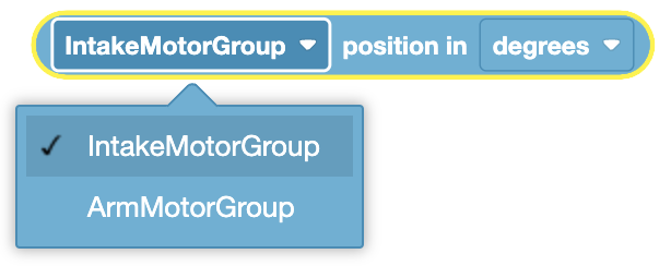

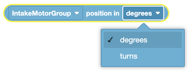

Position of motor#
The Position of motor block is used to report the position of a Motor or the first motor in a Motor Group.
([IntakeMotorGroup v] posición en [grados v])
Select when unit to use, degrees or turns.
motor_position_unit
The Position of motor block is used in blocks with circular spaces.
In this example, the robot will print the current position of the Arm Motor Group.
cuando empezó
imprimir ([ArmMotorGroup v] posición en [grados v]) ▶

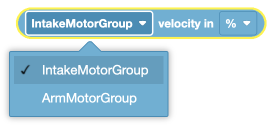

Velocity of motor#
The Velocity of motor block is used to report the current velocity of a Motor or the first motor in a Motor Group.
([IntakeMotorGroup v] velocidad en [% v] :: custom-motion)
The Velocity of motor block is used in blocks with circular spaces.
In this example, the robot will print the current velocity of the Intake Motor Group.
cuando empezó
imprimir ([IntakeMotorGroup v] velocidad en [% v] :: custom-motion) ▶
