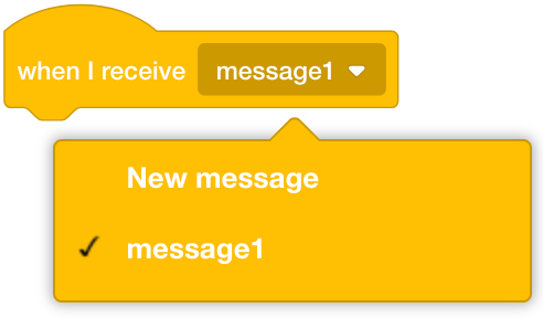

When I Receive#
The When I Receive block is used to run the attached stack of blocks when the selected message is received from a broadcasted message.
  when I receive [message1 v]
Choose which message to listen for. A new message can also be created.

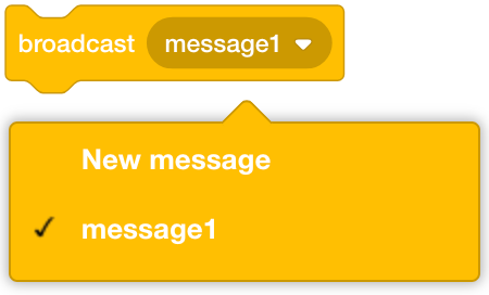

Broadcast#
The Broadcast block is used to broadcast a message to activate any stacks that begin with a When I Receive block listening for the broadcasted message.
  broadcast (message1 v)
The stack that sends the broadcast will continue to run blocks at the same time as other stacks that receive the broadcasted message.
Choose which message to broadcast. A new message can also be created.
