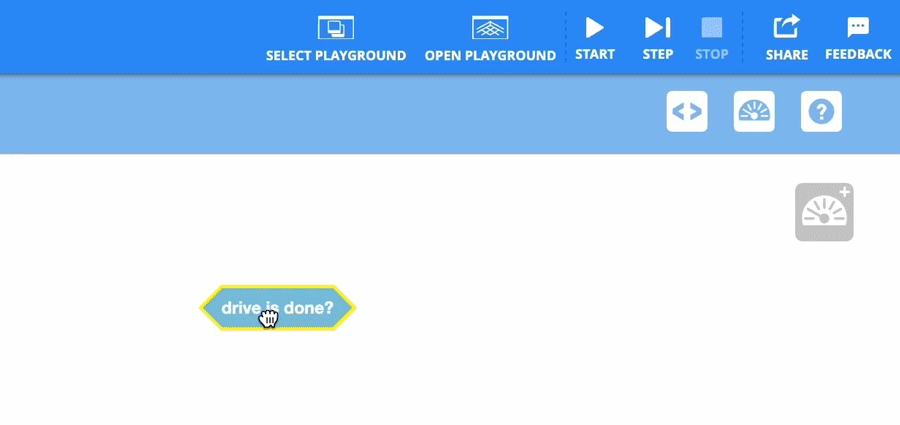

To put a variable in the Monitor Console, drag and drop its Reporter block to the Monitor Icon on the right side of the screen.
Animation showing a user dragging the 'drive is done?' block from the workspace to the Monitor Console, located at the top right of the screen. The block is moved over the small monitor icon in the top right corner of the coding environment.

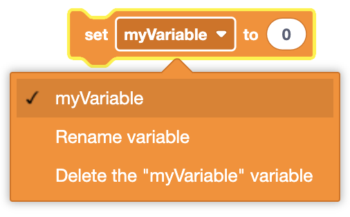

Set numeric variable#
The Set numeric variable block is used to set a numeric variable to a given value. Variables are created with global scope by default.
A VEXcode blocks stack of code containing a block that sets [myVariable v] to 0.#
    set [myVariable v] to [0]
Choose which numeric variable to use. Numeric variables can also be renamed or deleted.
An orange notched coding block with a dropdown menu open, displaying options to select 'myVariable,' rename the variable, or delete the 'myVariable' variable.

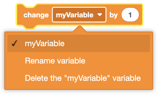

Change numeric variable#
The Change numeric variable block is used to change a variable by the given value.
A VEXcode blocks stack of code containing a block that changes [myVariable v] by 1.#
    change [myVariable v] by (1)
Choose which numeric variable to use - the selected variable can also be renamed or deleted.
An orange notched coding block with the text 'change myVariable by 1' and a dropdown menu expanded below it, showing options to select 'myVariable', rename the variable, or delete the 'myVariable' variable.

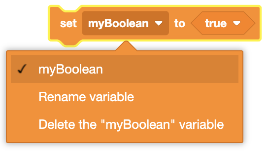

Choose which boolean variable to use. Boolean variables can also be renamed or deleted.
A notched coding block with the text 'set myBoolean to true' with dropdown menus for the variable name and Boolean value, and an open dropdown menu displaying options to rename or delete the variable.

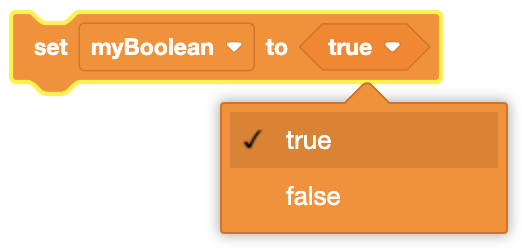

Choose a Boolean value.
A notched coding block with the text 'set myBoolean to true' with dropdown menus for the variable name and Boolean value, and an open dropdown menu showing options 'true' (selected) and 'false' for the Boolean value.

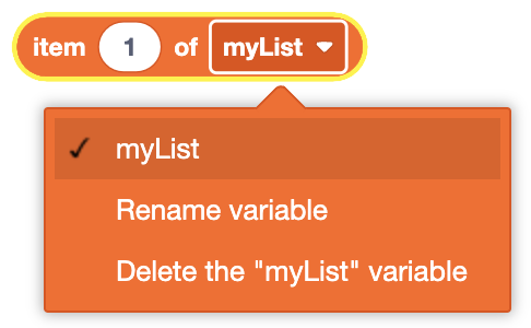

List item#
The List item block is used to report the value of an item in a list.
a VEXcode stack of code blocks containing a list item block#
    (item (1) of [myList v])
Choose which list to use. The list can also be renamed or deleted.
A rounded coding block labeled 'item 1 of myList,' with '1' in a white bubble and 'myList' in a dropdown menu. Below the block, an orange dropdown menu is expanded, showing options: 'myList' (selected), 'Rename variable,' and 'Delete the "myList" variable.'"
Enter the number of the item’s position within the list. Here, the second item in list (item 2) is being reported.
The List item block can accept decimals, integers, or numeric blocks.

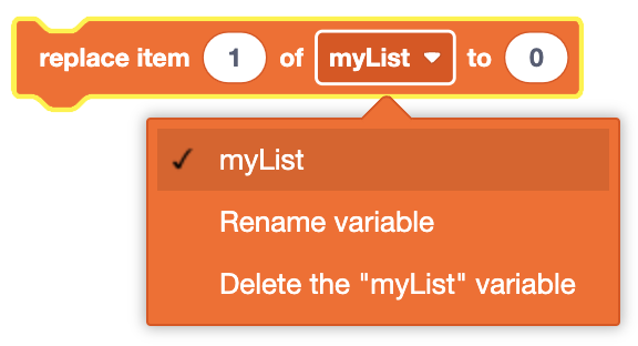

Replace List item#
The Replace List item block is used to update an item in the list to a new value.
a VEXcode stack of code blocks that contains a replace list item block#
    replace item (1) of [myList v] to (0)
A coding block labeled 'replace item 1 of myList to 0' with a dropdown menu expanded below, showing options to select 'myList', 'Rename variable', or 'Delete the "myList" variable'.
The Replace List item block can accept decimals, integers, or numeric blocks.

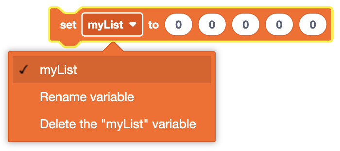

Set List item#
The Set List item block is used to set every item in the list to the entered values. Variables are created with global scope by default.
a VEXcode stack of blocks containing a set list item block.#
    set [myList v] to (0) (0) (0) (0) (0)
Choose which 2D list to use. The 2D list can also be renamed or deleted.

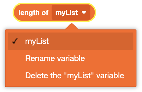

Length of List#
The Length of List block is used to report the number of items in a list.
a VEXcode stack of code blocks containing a length of list block#
    (length of [myList v] :: list)
Choose which list to use. The 2D list can also be renamed or deleted.
A rounded coding block displaying 'length of myList' in orange, with a dropdown menu open showing options to select, rename, or delete the 'myList' variable.

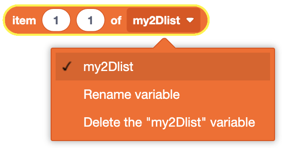

2D List item#
The 2D List item block is used to report the value of an item in a 2D list.
a VEXcode stack of code blocks containing a 2D list item block#
    (item (1) (1) of [my2Dlist v])
An orange coding block labeled 'item 1 1 of my2DList,' with a dropdown menu open showing options to select 'my2DList,' rename the variable, or delete the 'my2DList' variable. The block has two white circular inputs, both set to '1,' and the 'my2DList' variable is in a notched shape.
Enter the item’s row (first number) and column (second number) position within the list to be reported. Here, the item in position row 2, column 3 in the 2D list is being reported.

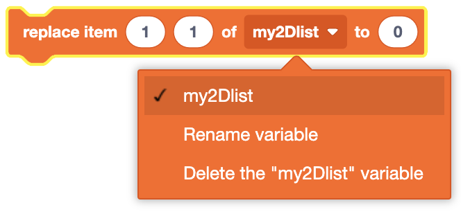

Replace 2D List item#
The Replace 2D List item block is used to update an item in the 2D list to a new value.
a VEXcode blocks stack of code containing a replace 2d list item block#
    replace item (1) (1) of [my2Dlist v] to (0)
An orange coding block with the text 'replace item 1 1 of my2Dlist to 0,' with a dropdown menu open showing options for the variable 'my2Dlist,' as well as options to rename or delete the variable.
The Replace 2D List item block can accept decimals, integers, or numeric blocks.

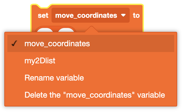

An orange coding block labeled 'set move_coordinates to' with a dropdown menu open below. The dropdown menu shows the options: 'move_coordinates' (selected), 'my2Dlist,' 'Rename variable,' and 'Delete the "move_coordinates" variable.'"

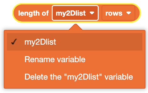

Length of 2D List#
The Length of 2D List block is used to report the number of rows or columns in a 2D list.
a VEXcode stack of code blocks containing a length of 2d list block#
    (length of [my2Dlist v] [rows v])
A rounded, orange coding block labeled 'length of my2Dlist rows' with a dropdown menu expanded, showing options 'my2Dlist,' 'Rename variable,' and 'Delete the "my2Dlist" variable.'"

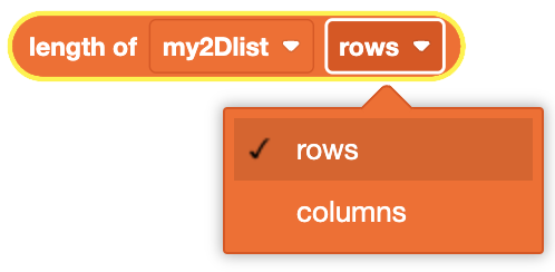

Choose which value to report. The 2D list can report either rows or columns.
A rounded, orange coding block labeled 'length of my2Dlist rows' with the 'rows' dropdown menu expanded, showing options 'rows' and 'columns,' with 'rows' selected.

In this example, the Robot will print how many rows there are in the moveCoordinates 2D List.
a VEXcode stack of code blocks containing a when started block and a print block that prints the length of moveCoordinates.#
    when started
    print (length of [moveCoordinates v] [rows v]) on console ▶
