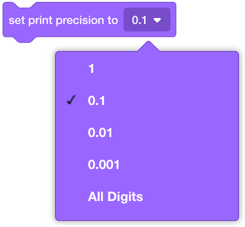

The Set print precision block is used to set the number of digits that appear after the decimal point when printing reporter blocks on the Print Console.
  set print precision to [0.1 v]
Choose the level of precision that inserted reporter blocks will be printed to the screen.
  • Ones (1) (Default)
  • Tenths (0.1)
  • Hundredths (0.01)
  • Thousandths (0.001)
  • All Digits (0.000001)
set_print_precision_select

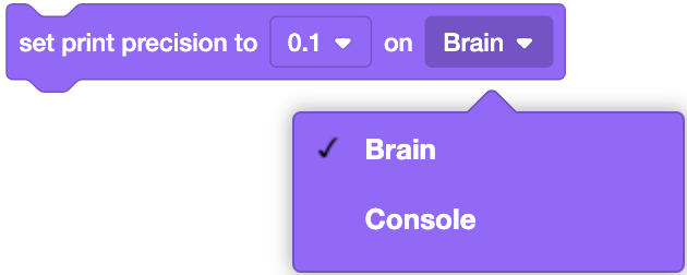

Choose which device to use.
set_print_precision_device

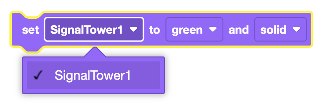

Select which Signal Tower to use.
set_signal_tower_tower

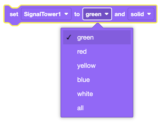

Select which color on the Signal Tower to set the state of.
  • red
  • yellow
  • green
  • blue
  • white
  • all
set_signal_tower_color

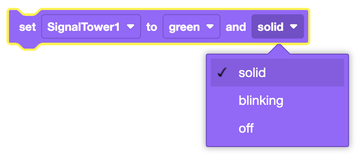

Select which state for the specified color on the Signal Tower to be.
  • off - Turns the color’s light off.
  • solid - Turns the color’s light on.
  • blinking - Turns the color’s light on and off repeatedly.
set_signal_tower_state
