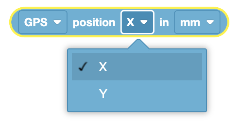

Select either the X or Y axis offset of the robot’s turning reference point from the center of the field to report.
Diagram illustrating GPS position and heading blocks for VEXcode VR robot programming.

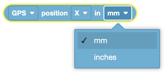

Select what unit to report the offset value in, millimeters (MM) or inches.
Image of a GPS position unit used in VEXcode VR for reporting robot's positional offset and heading.
