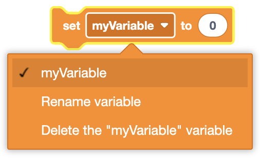

Set numeric variable#
The Set numeric variable block is used to set a numeric variable to a given value. Variables are created with global scope by default.
    set [myVariable v] to [0]
Choose which numeric variable to use. Numeric variables can also be renamed or deleted.
An orange notched coding block with a dropdown menu open, displaying options to select 'myVariable,' rename the variable, or delete the 'myVariable' variable.
The Set numeric variable block can accept decimals, integers, or numeric blocks.
In this example, the variable driveLength is set to 500 and used in the Drive for block. This makes the Drive for block move forward for 500 mm.

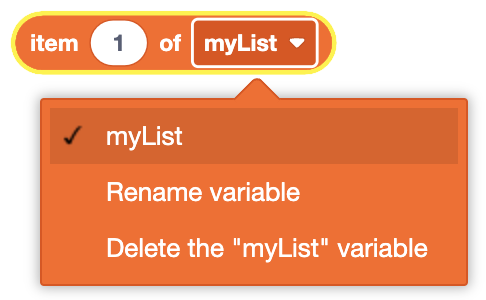

List item#
The List item block is used to report the value of an item in a list.
    (item (1) of [myList v])
Choose which list to use. The list can also be renamed or deleted.
A rounded coding block labeled 'item 1 of myList,' with '1' in a white bubble and 'myList' in a dropdown menu. Below the block, an orange dropdown menu is expanded, showing options: 'myList' (selected), 'Rename variable,' and 'Delete the "myList" variable.'"
Enter the number of the item’s position within the list. Here, the second item in list (item 2) is being reported.
The List item block can accept decimals, integers, or numeric blocks.
In this example, the cardinalHeadings list stores the degrees for north, east, south, and west. The Drivetrain turns to face item 3, which is set to 180 degrees.
    when started
    set [cardinalHeadings v] to (0) (90) (180) (270)
    turn to heading (item (3) of [cardinalHeadings v]) degrees ▶

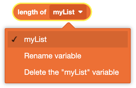

Length of List#
The Length of List block is used to report the number of items in a list.
    (length of [myList v] :: list)
Choose which list to use. The 2D list can also be renamed or deleted.
A rounded coding block displaying 'length of myList' in orange, with a dropdown menu open showing options to select, rename, or delete the 'myList' variable.
The Length of List reporter block fits in blocks that accept circular spaces.
In this example, the length of the cardinalHeadings list will be printed to the Console.
    when started
    print (length of [cardinalHeadings v] :: list) ▶

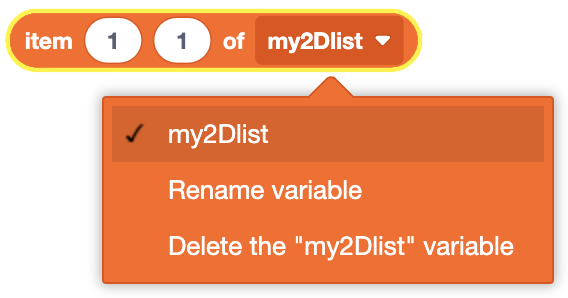

2D List item#
The 2D List item block is used to report the value of an item in a 2D list.
    (item (1) (1) of [my2Dlist v])
Choose which 2D list to use. The 2D list can also be renamed or deleted.
An orange coding block labeled 'item 1 1 of my2DList,' with a dropdown menu open showing options to select 'my2DList,' rename the variable, or delete the 'my2DList' variable. The block has two white circular inputs, both set to '1,' and the 'my2DList' variable is in a notched shape.
Enter the item’s row (first number) and column (second number) position within the list to be reported. Here, the item in position row 2, column 3 in the 2D list is being reported.
    (item (2) (3) of [my2Dlist v])
The 2D List item block can accept decimals, integers, or numeric blocks.
In this example, the moveCoordinates 2D List is used to store numeric values that relate to positions on the playground. Assuming that the Robot starts at the coordinate (0, 0), the Drivetrain uses the items from (5,1) and (5,2) in the 2D List to move to the coordinate (300, 200).
    when started
    set [move_coordinates v] to ((300)(150)) ((500)(200))
    drive [forward v] for (item (1) (1) of [move_coordinates v]) [mm v] ▶
    turn [right v] for (90) degrees ▶
    drive [forward v] for (item (1) (2) of [move_coordinates v]) [mm v] ▶

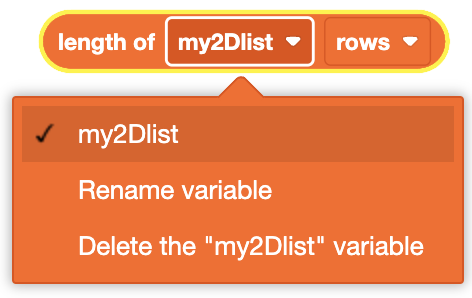

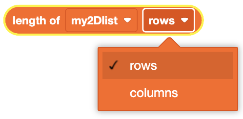

Length of 2D List#
The Length of 2D List block is used to report the number of rows or columns in a 2D list.
    (length of [my2Dlist v] [rows v])
A rounded, orange coding block labeled 'length of my2Dlist rows' with a dropdown menu expanded, showing options 'my2Dlist,' 'Rename variable,' and 'Delete the "my2Dlist" variable.'"
Choose which value to report. The 2D list can report either rows or columns.
A rounded, orange coding block labeled 'length of my2Dlist rows' with the 'rows' dropdown menu expanded, showing options 'rows' and 'columns,' with 'rows' selected.
The Length of 2D List reporter block fits in blocks that accept circular spaces.
