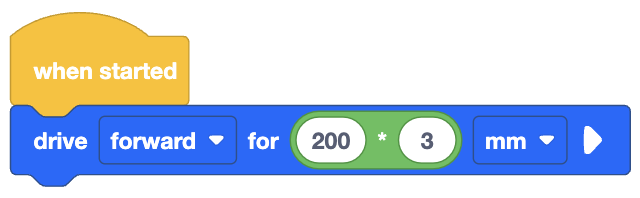

math operator#
The math operator block performs basic arithmetic on the values placed on either side. It returns a result based on the project’s print precision, which defaults to 0 decimal places but can be adjusted using the set print precision block.
The Math operator reporter block.#
