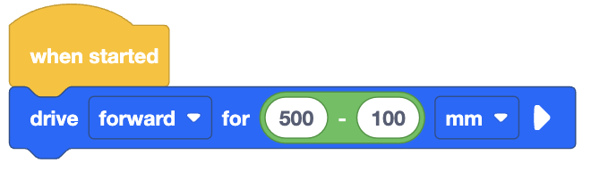

Subtract#
The Subtract block is used to subtract one value from another and reports the difference.
VEXcode blocks stack of code containing a subtract block.#
  ((0) - (0))
The Subtract block can accept decimals, integers, or numeric blocks.
The Subtract block fits in blocks that accept circular spaces, and can accept other circular blocks in it as well.
In this example, the Drivetrain will move forward for 400 mm.
VEXcode blocks stack of code containing a when started block, and a drive forward for 500 minus 100 mm block.#
  when started :: hat events
  drive [forward v] for ((500) - (100)) [mm v] ▶

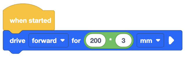

Multiply#
The Multiply block is used to multiply any two values together and reports the product.
VEXcode blocks stack of code containing a multiply block.#
  ((0) * (0))
The Multiply block can accept decimals, integers, or numeric blocks.
The Multiply block fits in blocks that accept circular spaces, and can accept other circular blocks in it as well.
In this example, the Drivetrain will move forward for 600 mm.
VEXcode blocks stack of code containing a when started block, and a drive forward for 200 multiplied by 3 mm block.#
  drive [forward v] for ((200) * (3)) [mm v] ▶

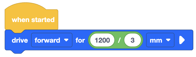

Divide#
The Divide block is used to divide the first value by the second value and reports the dividend.
VEXcode blocks stack of code containing a divide block.#
  ((0) / (0))
The Divide block can accept decimals, integers, or numeric blocks.
The Divide block fits in blocks that accept circular spaces, and can accept other circular blocks in it as well.
VEXcode blocks stack of code containing a when started block, and a drive forward for 1200 divided by 3 mm block.#
  drive [forward v] for ((1200) / (3)) [mm v] ▶

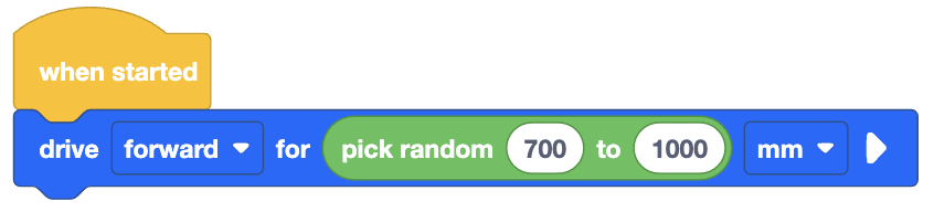

Random#
The Random block is used to report a random value between the lowest and highest values in the block.
VEXcode blocks stack of code containing a random operator block.#
  (pick random (1) to (10))
The Random block can accept decimals, integers, or numeric blocks.
In this example, the Drivetrain will move forward for a random distance between 700 and 1000 mm.
VEXcode blocks stack of code containing a when started block, and a drive forward for pick random 700 to 1000 mm block.#
  drive [forward v] for (pick random (700) to (1000)) [mm v] ▶

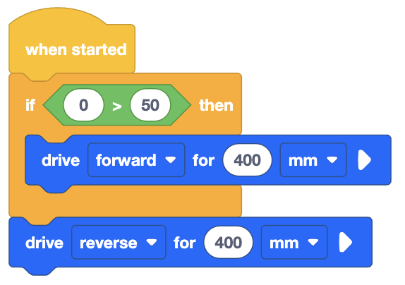

Greater than#
The Greater than block is used to report if the first value is larger (greater) than the second value.
VEXcode blocks stack of code containing a greater than block.#
  <(0) > (50)>
The Greater than block can accept decimals, integers, or numeric blocks.
The Greater than block reports true when the first value is larger than the second value and false when the first value is smaller than or equal to the second value.
The Greater than Boolean block reports a true or false value and fits in blocks with hexagonal (six-sided) spaces.
In this example, the Drivetrain will move in reverse for 400 mm, because 0 > 50 returns False.
VEXcode blocks stack of code containing a when started block, an if 0 greater than 50 then block, a drive forward for 400 mm block, an end block, and a drive reverse for 400 mm block.#
  if <(0) > (50)> then
  drive [forward v] for (400) [mm v] ▶
  end
  drive [reverse v] for (400) [mm v]  ▶

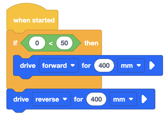

Less than#
The Less than block is used to report if the first value is less (smaller) than the second value.
VEXcode blocks stack of code containing a less than block.#
  <(0) < (50)>
The Less than block can accept decimals, integers, or numeric blocks.
The Less than block reports true when the first value is smaller than the second value and reports false when the first value is greater than or equal to the second value.
The Less than Boolean block reports a true or false value and fits in blocks with hexagonal (six-sided) spaces.
In this example, the Drivetrain will move forward for 400 mm, because 0 < 50 returns True.
VEXcode blocks stack of code containing a when started block, an if 0 less than 50 then block, a drive forward for 400 mm block, an end block, and a drive reverse for 400 mm block.#
  if <(0) < (50)> then
  end

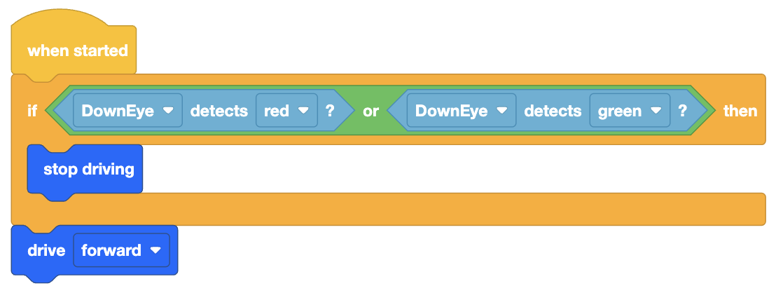

Or#
The Or block is used to report if one of two Boolean conditions are true.
VEXcode blocks stack of code containing an or block.#
  <<> or <>>
The Or block reports true when one (or both) of the conditions are true and reports false when both of the conditions are false.
The Or Boolean block reports a true or false value and fits in blocks with hexagonal (six-sided) spaces.
In this example, if the Down Eye sensor detects a red or green object, the Drivetrain will stop. Otherwise, the Drivetrain will keep moving forward.
VEXcode blocks stack of code containing a when started block, an if DownEye detects red ? or DownEye detects green ? then block, a stop driving block, an end block, and a drive forward block.#
  if <<[DownEye v] detects [red v] ?> or <[DownEye v] detects [green v] ?>> then
  stop driving
  end
  drive [forward v]

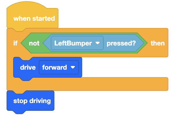

Not#
The Not block is used to report the opposite (inverse) of the reported Boolean value.
VEXcode blocks stack of code containing a Not block.#
  <not <>>
The Not block reports true when the Boolean block inside reports false and reports false when the Boolean block inside reports true.
The Not Boolean block reports a true or false value and fits in blocks with hexagonal (six-sided) spaces.
In this example, if the Left Bumper Sensor has not been pressed, the Drivetrain will move forward. If the Left Bumper Sensor has been pressed, the Drivetrain will stop.
VEXcode blocks stack of code containing a when started block, an if not LeftBumper pressed ? then block, a drive forward block, an end block, and a stop driving block.#
  if <not <[LeftBumper v] pressed?>> then
  drive [forward v]
  end
  stop driving

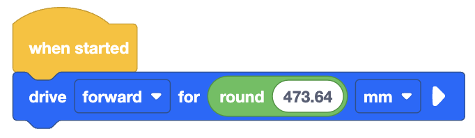

Round#
The Round block is used to round the inputted value to the nearest integer.
VEXcode blocks stack of code containing a Round block.#
  (round (0))
The Round block can accept decimals, integers, or numeric blocks.
Decimals that are 0.5 or greater round up and decimals less than 0.5 round down.
The Round block fits in blocks that accept circular spaces, and can accept circular blocks in them as well.
In this example, the Drivetrain will move forward for the rounded number of 474 mm.
VEXcode blocks stack of code containing a when started block, and a drive forward for round 473.64 mm block.#
  drive [forward v] for (round (473.64)) [mm v] ▶

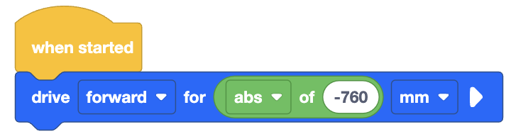

Function#
The Function block is used to perform a selected math function.
VEXcode blocks stack of code containing a function block.#
  ([abs v] of (0))
The Function block can accept decimals, integers, or numeric blocks.
The available functions are:
  • abs - absolute value
  • floor - rounds down to the nearest integer
  • ceiling - rounds up to the nearest integer
  • sqrt - square root
  • sin - sine
  • cos - cosine
  • tan - tangent
  • asin - arcsine or the inverse of sine
  • acos - arccosine or the inverse of cosine
  • atan - arctan or the inverse of tangent
  • ln - the natural logarithm base e
  • log - logarithm base 10
  • e ^ - powers of e
  • 10 ^ - powers of 10
The Function block fits in blocks that accept circular spaces, and can accept circular blocks in them as well.
In this example, the Drivetrain will move forward for 760 mm.
VEXcode blocks stack of code containing a when started block, and a drive forward for abs of -760 mm block.#
  drive [forward v] for  ([abs v] of (-760)) [mm v] ▶

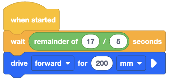

Remainder#
The Remainder block is used to divide the first value by the second value and report the remainder.
VEXcode blocks stack of code containing a remainder block.#
  (remainder of (0) / (0))
The Remainder block can accept decimals, integers, or numeric blocks.
Numbers that divide evenly will report a remainder of zero.
The Remainder block fits in blocks that accept circular spaces, and can accept circular blocks in them as well.
In this example, the Drivetrain will wait 2 seconds before moving forward for 200 mm.
VEXcode blocks stack of code containing a when started block, a wait remainder of 17 divided by 3 seconds block, and a drive forward for 200 mm block.#
  wait (remainder of (17) / (5)) seconds
  drive [forward v] for (200) [mm v] ▶

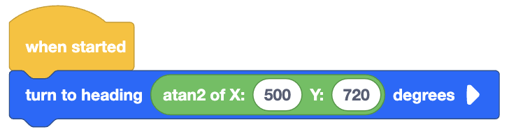

ArcTan2#
The ArcTan2 block is used to perform the atan2(y, x) math function converted from radians to degrees. This function calculates the angle in degrees from the positive x-axis to a point (x, y), where ‘x’ is the horizontal coordinate and ‘y’ is the vertical coordinate.
VEXcode blocks stack of code containing a ArcTan2 block.#
  (atan2 of X: (1) Y: (1))
The ArcTan2 block can accept decimals, integers, or numeric blocks.
The ArcTan2 block reports a value in the range of -180 degrees to 180 degrees, representing the angle between the positive x-axis and the point (x, y).
The ArcTan2 block fits in blocks that accept circular spaces, and can accept circular blocks in them as well.
In this example, the Robot will turn to face the coordinate (500, 720).
VEXcode blocks stack of code containing a when started block, and a turn to heading atan2 of X 500 Y 720 degrees block.#
  turn to heading (atan2 of X: (500) Y: (720)) degrees ▶
