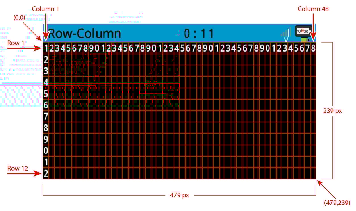

The V5 Brain’s screen has a set amount of rows and columns to use when printing text on its screen.
The number of available rows and columns change depending on the font selected with the Set Font block. The default font, Mono Medium has 5 rows and 16 columns available to be used.
Font Size |
Rows |
Columns |
Extra Small |
20 |
80 |
Small |
16 |
68 |
Medium (Default) |
12 |
48 |
Large |
8 |
32 |
Extra Large |
6 |
24 |
Super Large |
4 |
16 |

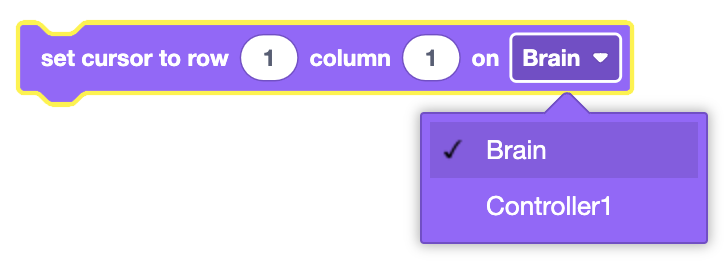

The Set Cursor block is used to set the cursor location for Print blocks on the V5 Brain’s screen or Controller’s screen.
set cursor to row (1) column (1) on Brain
The Set Cursor block accepts a range for row of 1 to 20 and a range for column of 1 to 80.
Choose which device to use.
In this example, the robot will print the current timer value on the Brain, clear the value, and reset back to the first column and row before printing again.

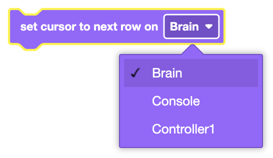

The Next Row block is used to set the print output cursor on the Print Console, V5 Brain’s screen, or Controller’s screen to the next available row.
set cursor to next row on [Brain v]
By default, all projects begin with the screen cursor at row 1 column 1. The Next Row block will move the cursor down by a single row on the screen. The Next Row block will also set the cursor’s column to position 1.
In this example, the robot will print “Hello” on the 1st row and “world!” on the 2nd row.

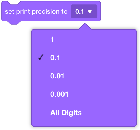

The Set Print Precision block is used to set the number of digits that appear after the decimal point when printing reporter blocks on the Print Console or V5 Brain’s screen.
set print precision to [0.1 v]
Choose the level of precision that inserted reporter blocks will be printed to the screen.
Ones (1) (Default)
Tenths (0.1)
Hundredths (0.01)
Thousandths (0.001)
All Digits (0.000001)

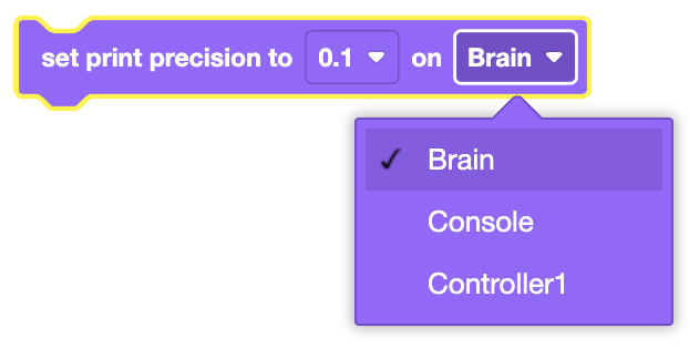

In this example, the print precision is set to hundredths before printing the current drivetrain heading.
when started
set print precision to [0.1 v] on [Brain v]
print (drive heading in degrees) on [Brain v] ◀ and set cursor to next row

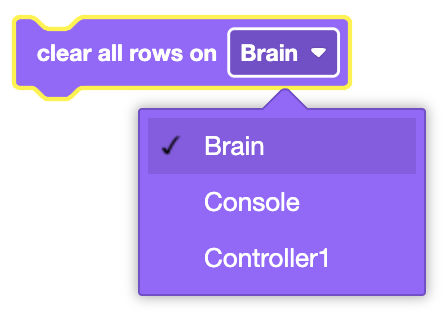

Clear All Rows#
The Clear All Rows block is used to clear the entire Print Console, V5 Brain’s screen, or Controller’s screen.
clear all rows on [Brain v]
Choose which device to clear.

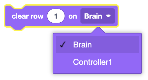

The Clear Row block is used to clear a single row on the V5 Brain’s screen or Controller’s screen.
clear row (1) on Brain
Choose which device to clear the row of.
In this example, the robot will print “VEXcode” on three different rows before deleting the “VEXcode” in the 2nd row.

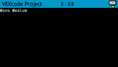

In this example, medium Monospace and Proportional fonts will be printed to the V5 Brain’s screen.
when started
set font to [Mono Medium v] on Brain
print [Mono Medium] on [Brain v] ◀ and set cursor to next row
set font to [Prop Medium v] on Brain
print [Prop Medium] on [Brain v] ◀ and set cursor to next row
