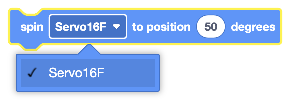

spin Servo to position#
The spin Servo to position stack block moves a Servo Motor to a specified position between 0 and 100 degrees. The Servo Motor will hold that position until it is given another position.
Note: A Servo Motor begins each project by automatically centering itself at 50 degrees before completing any movements.
A diagram of a servo motor showing the degrees that it can rotate, from 100 on the left to 50 in the center, to 0 on the far right.
  spin [ServoA v] to position [50] degrees
Parameters
Description
device
The Servo Motor to move. Choose from the Servo Motors configured in the Devices window.
position
The position to move the Servo Motor to, from 0 to 100 degrees. This uses whole numbers.
