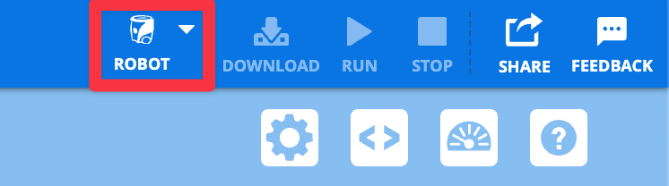

选择右上角的机器人图标#
Screenshot of the upper right hand corner of the VEXcode AIM toolbar with the Robot icon highlighted to the left of the Download icon.

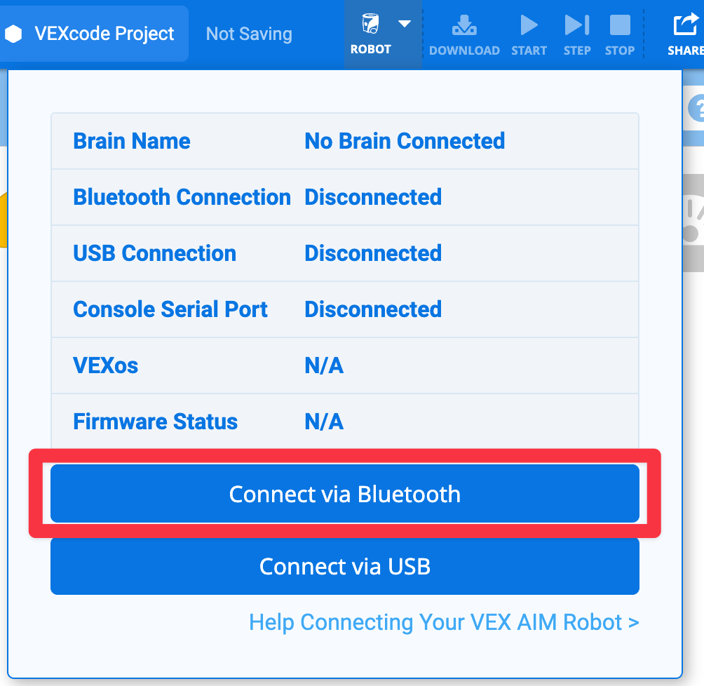

从菜单中选择通过蓝牙连接#
Screenshot of the connection dialog box, with the Connect via Bluetooth button on the bottom highlighted, directly above the Connect via USB button.
