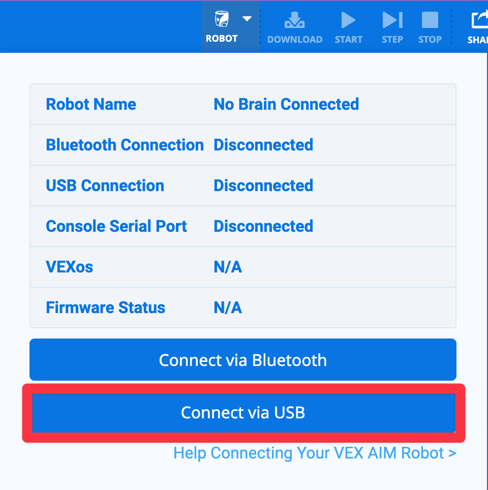

  1. Select Connect next to USB under Wired Connection.
Screenshot of the Connect menu, showing the Wired Connection and Wireless Connection sections, with the Connect button next to USB highlighted.

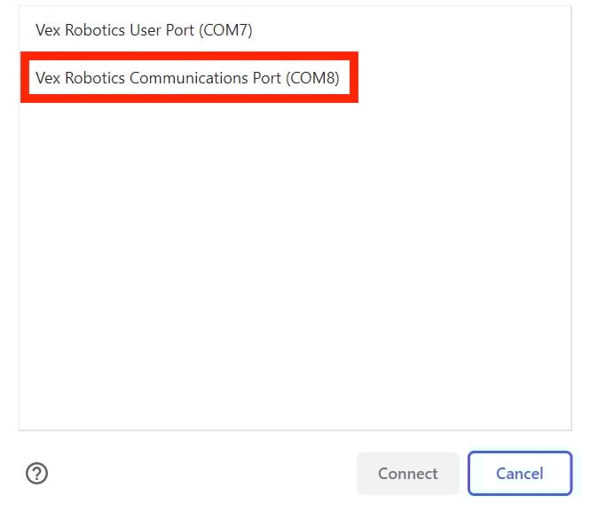

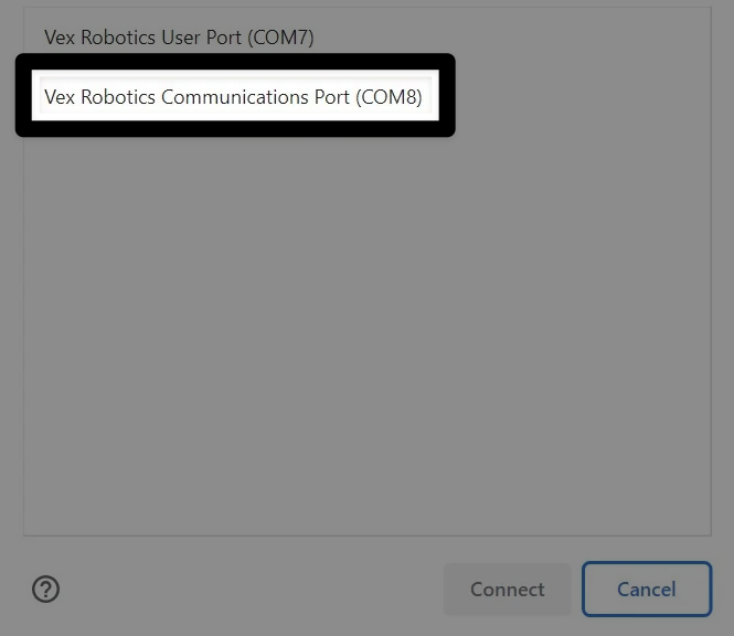

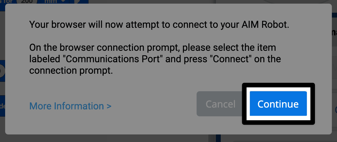

  1. Your browser will ask which serial port to connect to. Select Vex Robotics AIM - Vex Robotics Communications Port.
Screenshot of the serial port dialog on Windows, with the Vex Robotics AIM Communications Port entry highlighted.

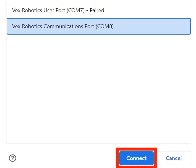

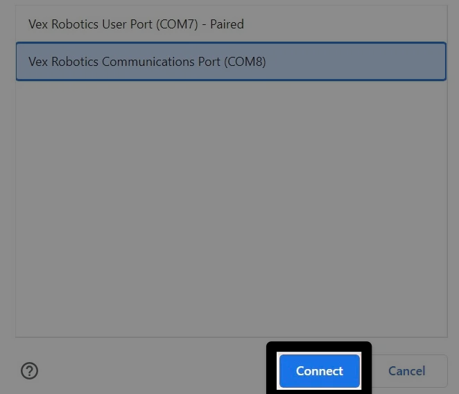

  1. Select Connect.
Screenshot of the serial port dialog on Windows, with the Communications Port selected and the Connect button highlighted.
