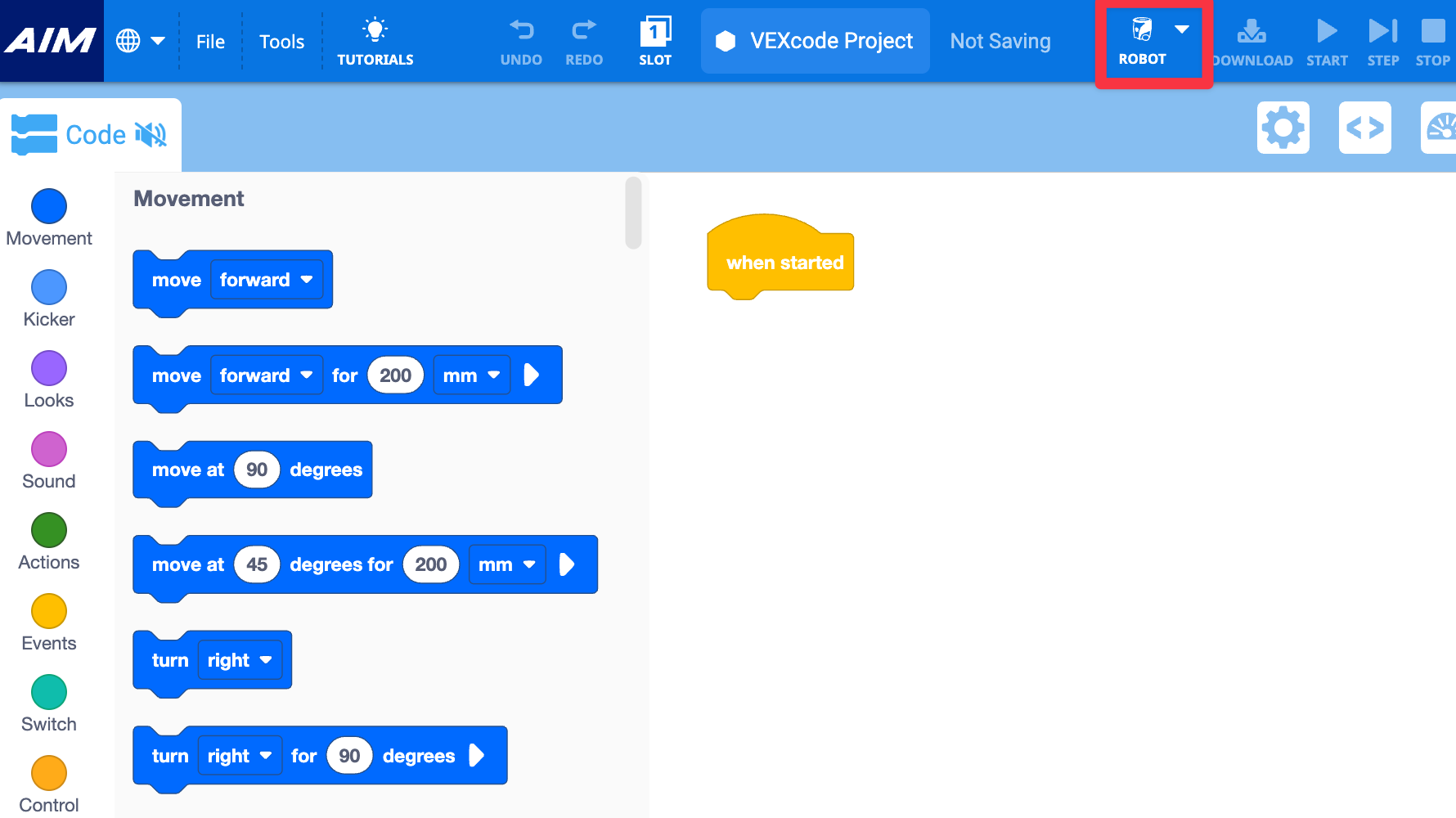

  1. Select the Connect button at the top-right of VEXcode.
Screenshot of the VEXcode AIM toolbar, with the Connect button highlighted.

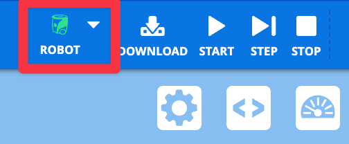

  1. Once connected, USB will show as Connected, and the Robot section will appear, showing its Device Name and battery level. The robot icon in the toolbar will also turn green, and the Connect button will now read Connected.
Screenshot of the Connect menu with USB shown as Connected, the green robot icon in the toolbar reading Connected, and the Robot section showing its Device Name and battery level.
