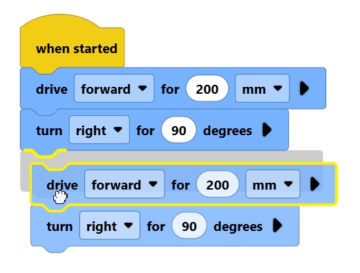

  1. Attach a drive for block and a turn for block below the when started block.
One side of the square, driving forward then turning right.#
    when started
        drive [forward v] for (200) [mm v] ▶
        turn [right v] for (90) degrees ▶

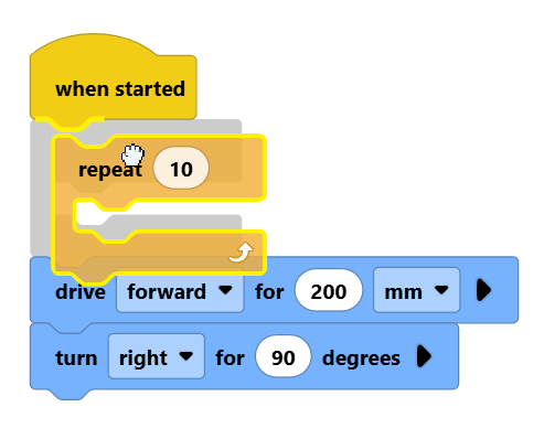

  1. Attach a repeat block below the when started block.
The repeat block, attached above the drive for and turn for blocks.#
    when started
        repeat (10)
        end

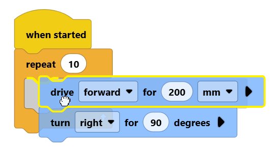

  1. Drag the drive for and turn for blocks inside the repeat block.
The drive for and turn for blocks, now inside the repeat block.#
    when started
        repeat (10)
        end
