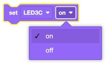

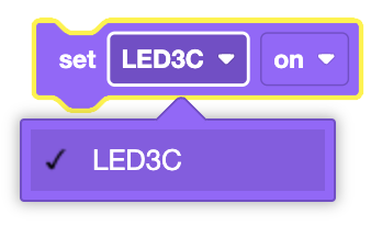

The Set LED block is used to turn an LED on or off.
aria-description goes here#
set [LED3C v] [on v]
Select which LED to use.
Select whether to turn the LED on or off. This is permanent until the Set LED block is used again. By default, an LED is set to Off.
In this example, the LED is turned on for two seconds before turning off.
