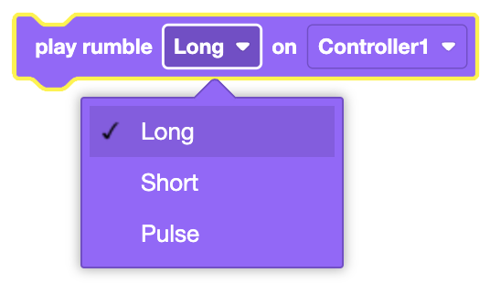

Choose which rumble pattern to use:
  • Long - a series of 4 long rumbles in a row.
  • Short - a series of 4 short rumbles in a row.
  • Pulse - a series of rumbles in a long, short, long, short pattern.

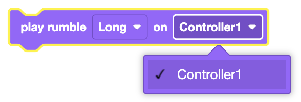

Image of a V5 controller demonstrating the Play Controller Rumble feature with rumble patterns displayed.
Choose which controller to use.
