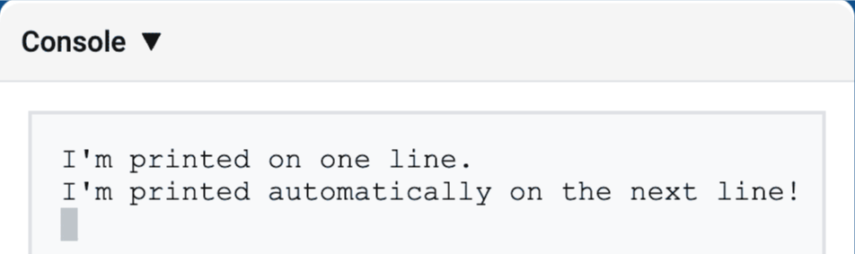

# Display two messages on separate lines
print("Hello, drone!")
print("This prints on the next line.")
VEXcode 控制台,显示控制台,第一行显示文本 "Hello, drone!",下一行显示 "This prints on the next line"。

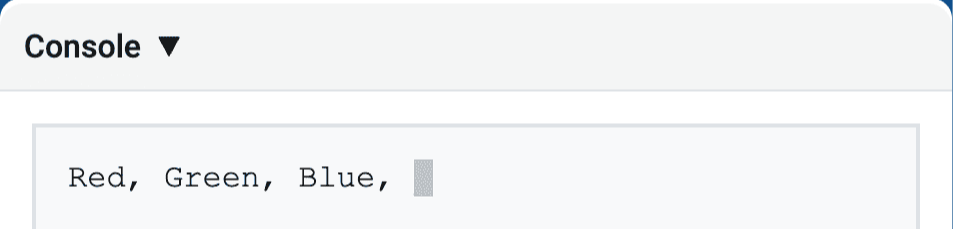

# Print three colors on one line, separated by commas
colors = ["Red", "Green", "Blue"]
for color in colors:
    print(color, end=", ")
VEXcode 控制台,显示控制台以及文本“Red, Green, Blue,”。

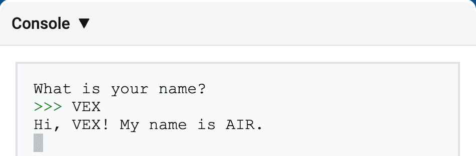

# Ask for a name, then print a greeting
answer = input("What's your name?")
print("Hello, " + answer)
VEXcode 控制台,显示控制台和文本“What's your name?”,后面跟着“>>VEX”,下方是“Hello VEX”
