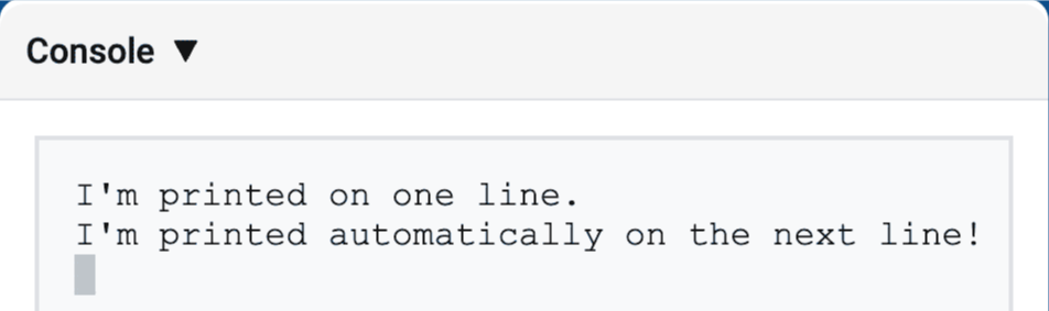

# Display two messages on separate lines
print("Hello, drone!")
print("This prints on the next line.")
The VEXcode Console, showing the Console and the text "Hello, drone!" displayed on the first line and "This prints on the next line" on the line below it.

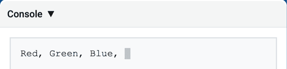

# Print three colors on one line, separated by commas
colors = ["Red", "Green", "Blue"]
for color in colors:
    print(color, end=", ")
The VEXcode Console, showing the Console and the text "Red, Green, Blue," displayed.

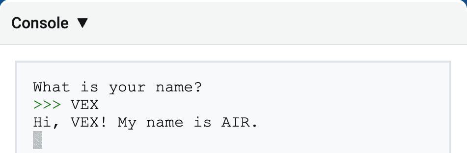

# Ask for a name, then print a greeting
answer = input("What's your name?")
print("Hello, " + answer)
The VEXcode Console, showing the Console and the text "What's your name?" followed by ">>> VEX" and beneath it, "Hello VEX"

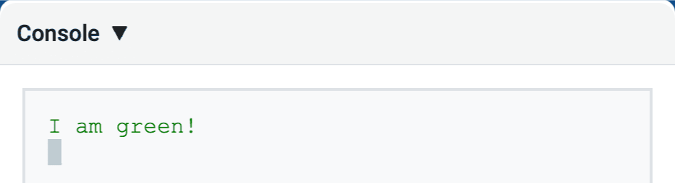

# Print text in different colors
print("Default text color")
set_console_text_color(RED)
print("Red text color")
The VEXcode Console, showing the Console and blue-colored text saying "Default text color" displayed on the first line and red-colored "Red text color" on the second line.
