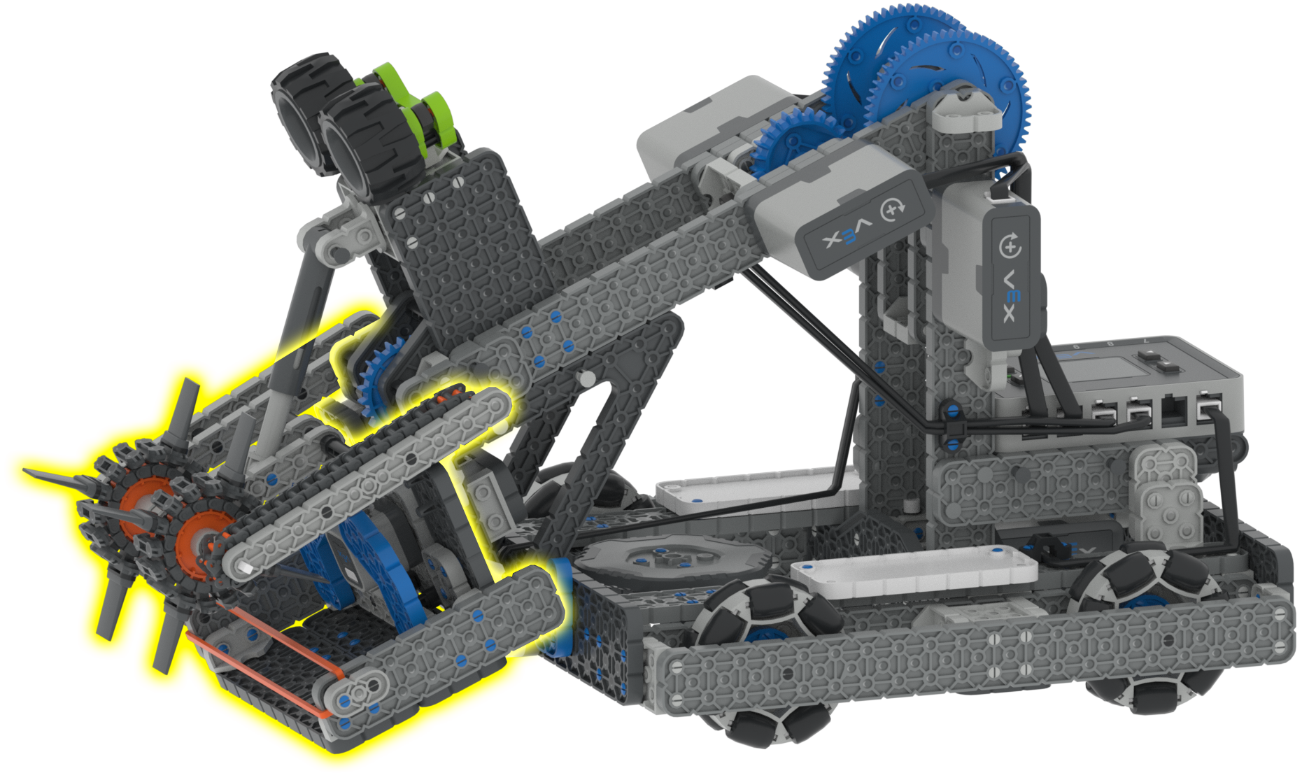

Byte is equipped with two sets of Motor Groups for its Arm and Intake.
Configuration & |
Description |
API Documentation |
The Arm can be raised and lowered. This allows the robot to do things like transport game objects. The Arm Motor Group starts at 0 degrees and will be fully raised when spun forward for 1300 degrees. |
The Intake can be spun forward and in reverse. This allows the robot to collect and score game objects. The Intake Motor Group starts at 0 degrees and will collect a Block when spun forward for 90 degrees, and score or drop a Block when spun in reverse for 90 degrees. |
