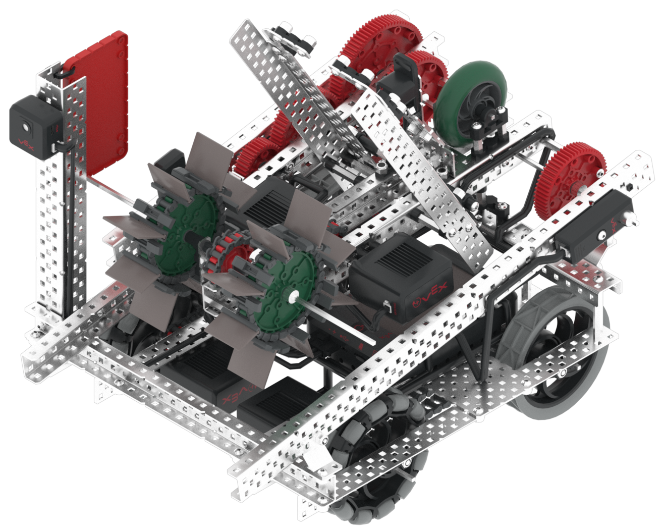

Robot Details#
The V5RC Virtual Skills - Over Under Playground uses the standard VEX V5 Hero Bot, Striker.
The Striker VEX V5 Hero Bot measures approximately 350 millimeters long and 280 millimeters wide.
Motor Groups#
Striker is equipped with two sets of Motor Groups for its Arm and Intake.
Configuration & |
Description |
API Documentation |
The Arm can be raised and lowered. This allows the robot to do things like transport game objects. By default, the Arm starts at 0 degrees and Arm will be fully lowered when spun forward for 1200 degrees. |
The Intake can be spun forward and in reverse. This allows the robot to collect and score game objects. The Intake will collect a Triball when spun forward 360 degrees and score or drop a Triball when spun in reverse for 360 degrees. |
