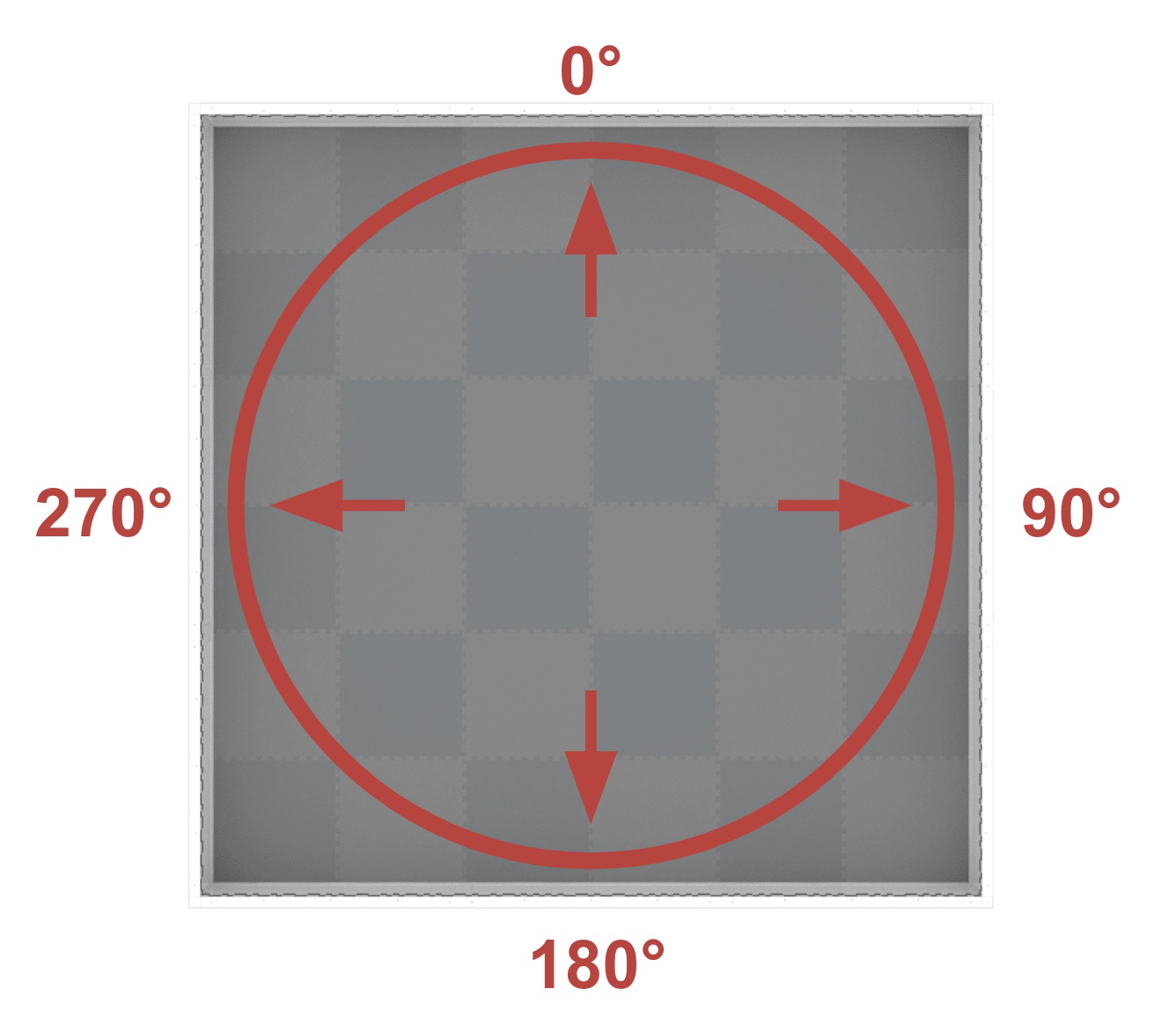

The heading method reports a range from 0.00 to 359.99 degrees.
航向对应于场方向,范围为顺时针方向 0º 至 359.9º。0º 位于 12 点钟位置。
设置gps_location_field
By default the heading method reports the heading of a GPS Sensor.
如果在配置 GPS 传感器时添加了角度偏移,则报告的航向将是机器人上的参考点。
**返回:**以指定单位表示的 GPS 传感器的当前航向。

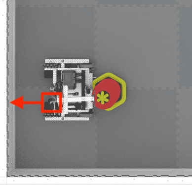

当 GPS 传感器距离场地墙壁太近而无法读取场地代码时(例如,当机器人处于场地上的比赛起始位置时),如果代码依赖于 GPS 的坐标和航向数据,则经常会出现意外行为。
The x and y parameters are the X and Y coordinates of the reference point on your robot on the field in this known location. The reference point on your robot is the same location that was used to calculate the offsets when configuring the GPS Sensor.
The heading parameter is the heading of the reference point on your robot. Using the example image above, the GPS Sensor is mounted facing behind the robot, while the reference point is at the end of the arm on the robot. Because the reference point is facing the right wall (heading of 90), the heading value that should be input is 90.
**返回:**无。
此处显示的示例设置了机器人(手臂)上的参考点的位置,以匹配机器人在场地上的位置。
// Wait so the GPS has time to initialize.
  wait(0.5, seconds)
  // Set the starting position to the bottom left corner of the Field facing the right wall.
  DrivetrainGPS.setLocation(-1200, -1200, mm, 90)
