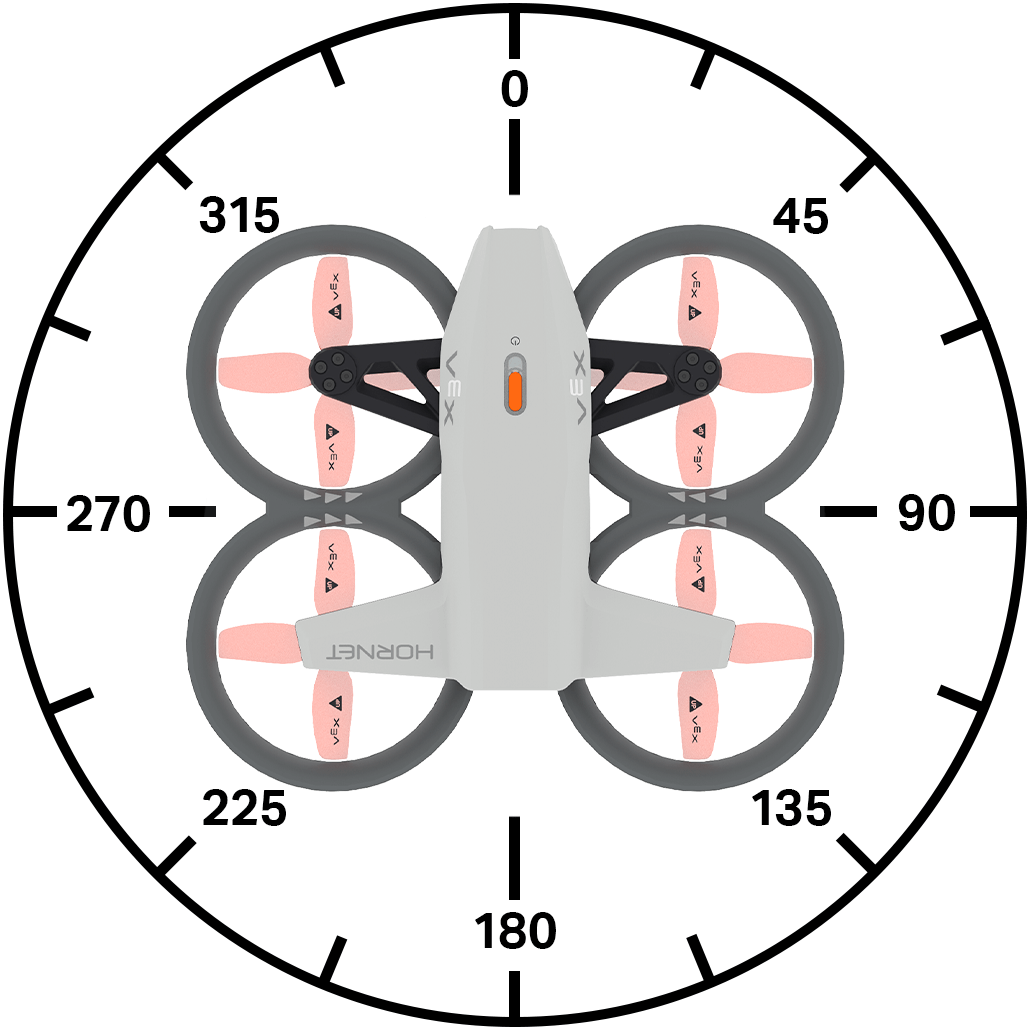

The VEX AIR Drone features four propellors, allowing it to move in any direction and rotate independently. Motion provides methods for movement, turning, velocity adjustments, and position tracking.
Circular compass dial from 0-360 degrees surrounding a drone with 4 propellers. The front of the drone faces 0 degrees on the compass dial.
