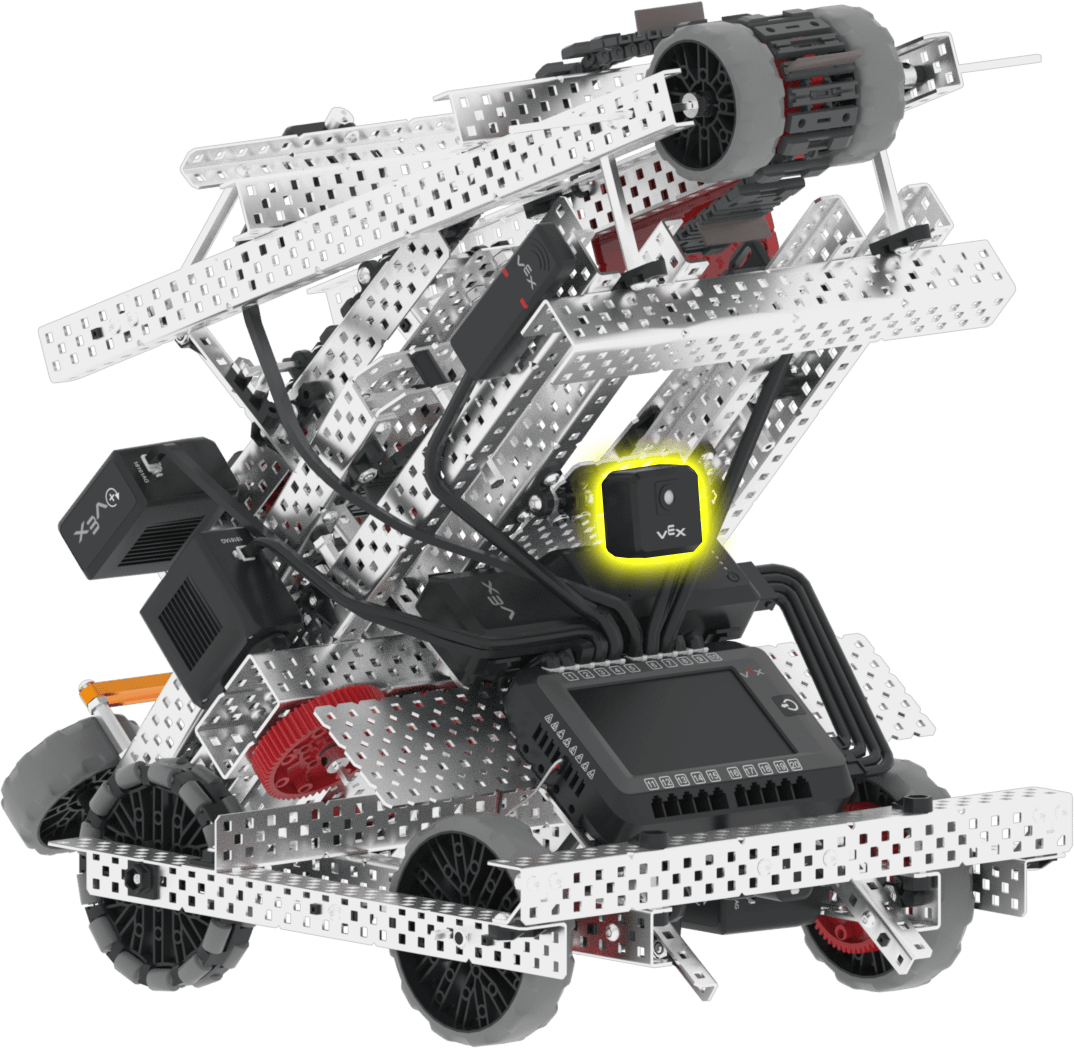

VEX robot chassis with mounted Vision Sensor highlighted in yellow, surrounded by V5 electronics and structural components.
For navigation, the GPS Sensor uses the Cartesian Coordinate system, with the field center designated as (0, 0). The sensor itself is a black and white camera mounted on the robot’s rear, facing backward to read the Field Code effectively.
The GPS Sensor reports the (X, Y) coordinates of Dex’s rotation center in either millimeters or inches. This enables precise tracking of the robot’s position within the VEXcode VR environment, allowing for accurate navigation and positioning during gameplay or programming tasks.

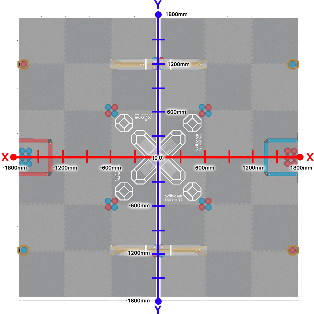

Identifying (X, Y) Coordinates on the Field#
The V5RC Push Back Field in VEXcode VR ranges from approximately -1800mm to 1800mm for the X and Y positions. The starting location of Dex depends on the starting position selected.
The center location, or the origin (0,0), is located in the center of the field.
VEX competition field with superimposed X and Y axis grid showing millimeter measurements from the center origin point (0,0).

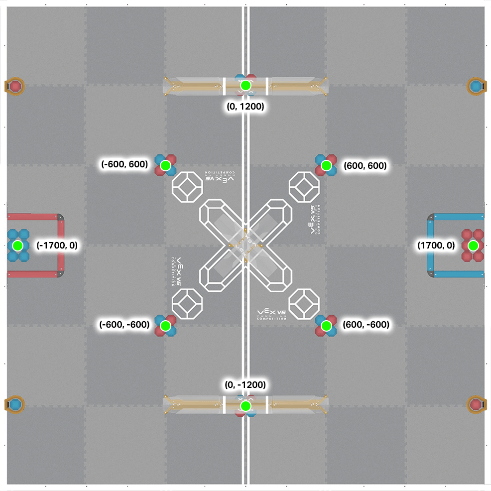

(X, Y) Coordinates of Game Elements#

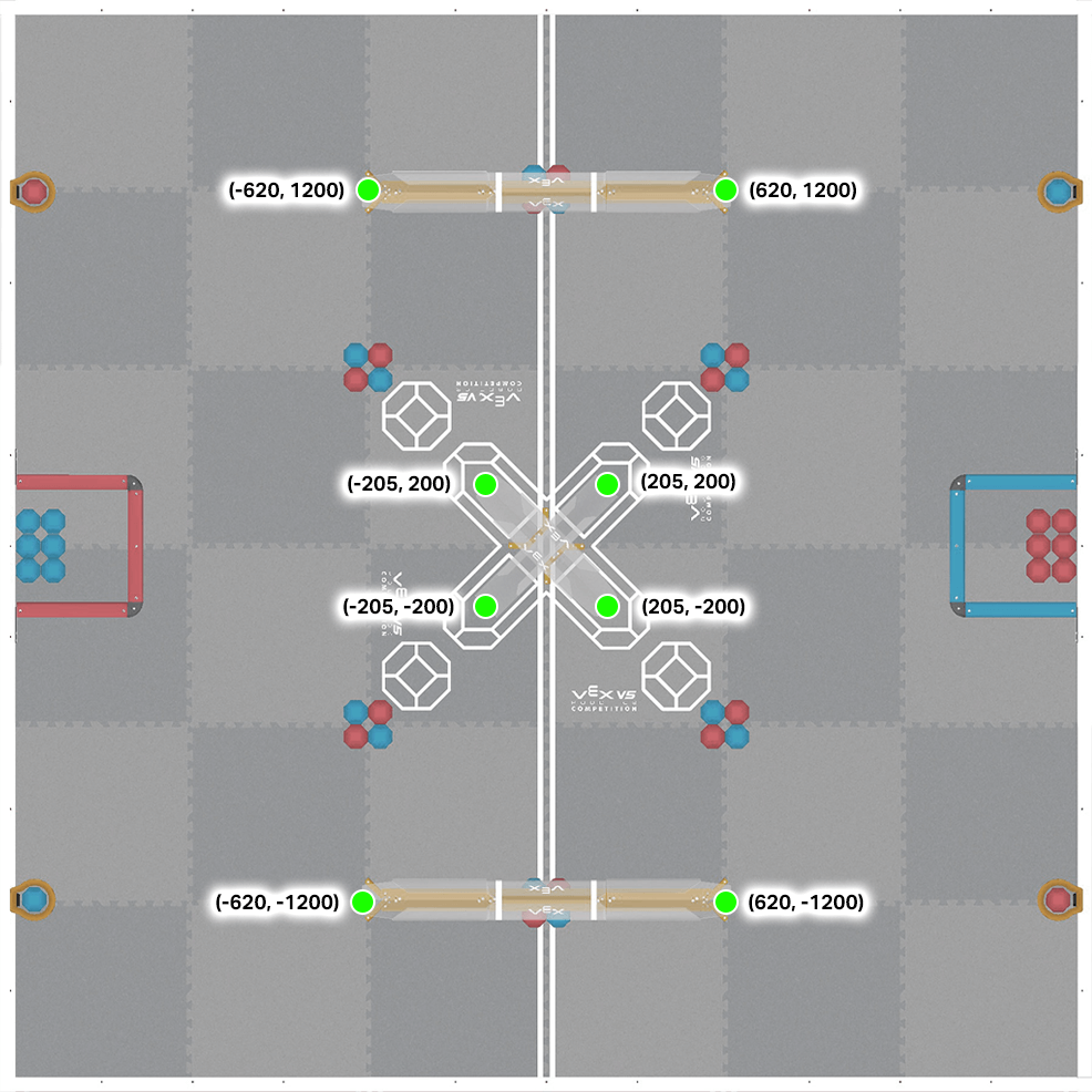

Goals#
VEX field labeled with specific coordinate points where goals are located, marked with green dots.
Blocks#
VEX game field showing coordinates of field objects such as blocks, marked with green dots and labeled X-Y positions.

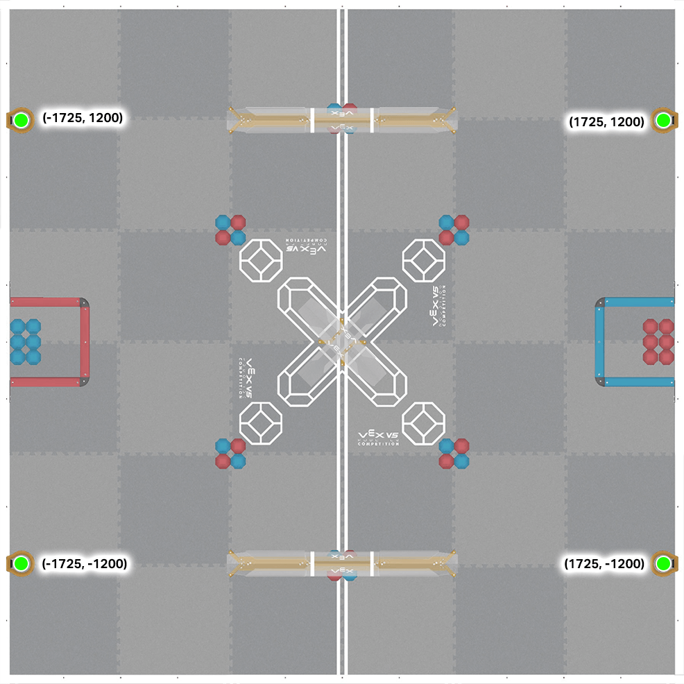

Loaders#
Top-down view of VEX field with the four loader locations labeled with their X-Y coordinates near the corners.
