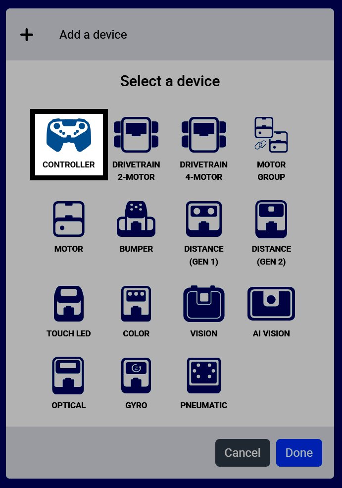

Select Controller#
Select Controller from the devices menu.
Screenshot of the Select a device screen, with Controller highlighted.

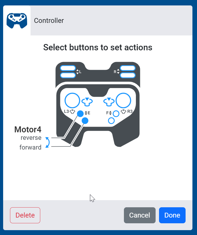

Set a Button to Control a Motor#
Selecting a button lets you choose which pair of buttons will control that device — one button for the forward direction, and the other for reverse.
Screenshot of the Select buttons to set actions screen, showing the E up and down buttons set to control Motor4's forward and reverse directions.

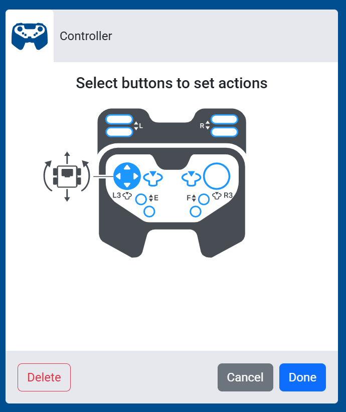

Left Arcade#
The left joystick controls both the Drivetrain’s forward and reverse movement and its turning.
Screenshot of the Select buttons to set actions screen, showing the left joystick set to control the Drivetrain's movement and turning together.

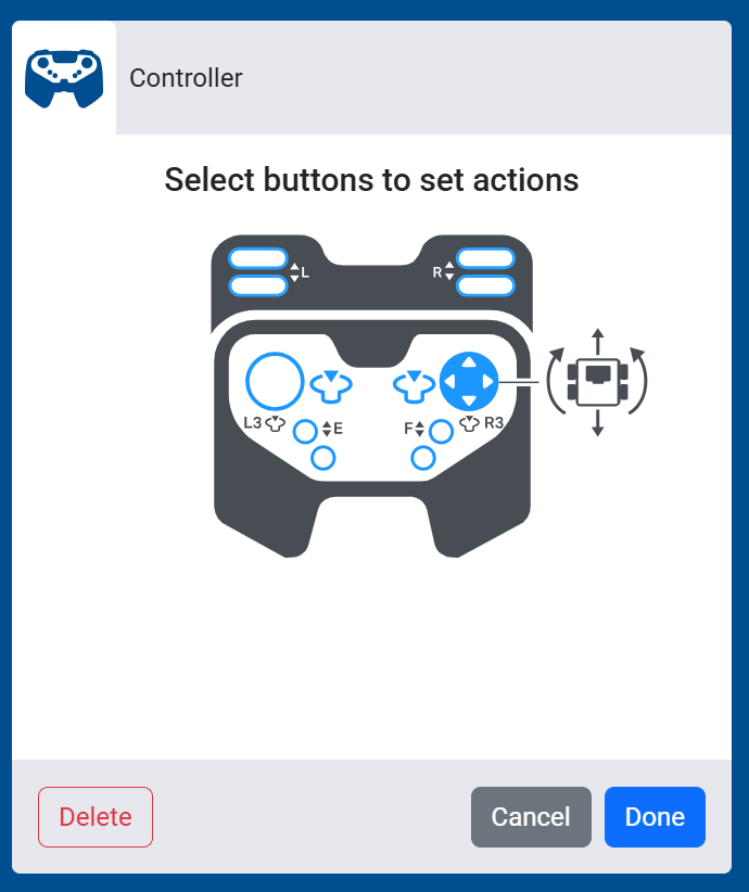

Right Arcade#
The right joystick controls both the Drivetrain’s forward and reverse movement and its turning.
Screenshot of the Select buttons to set actions screen, showing the right joystick set to control the Drivetrain's movement and turning together.

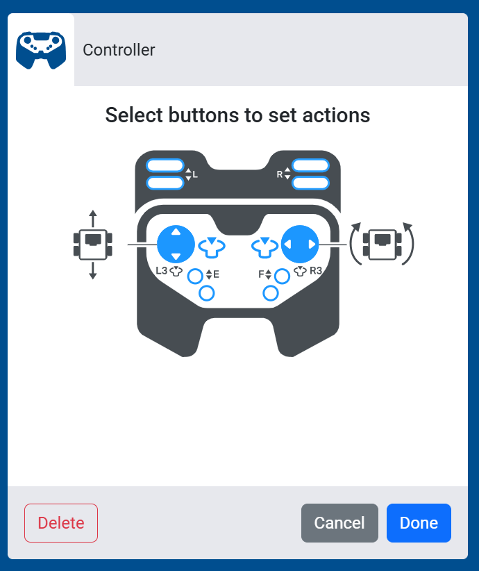

Split Arcade#
One joystick controls the Drivetrain’s forward and reverse movement, while the other joystick controls turning.
Screenshot of the Select buttons to set actions screen, showing the left joystick set to control forward and reverse movement, and the right joystick set to control turning.

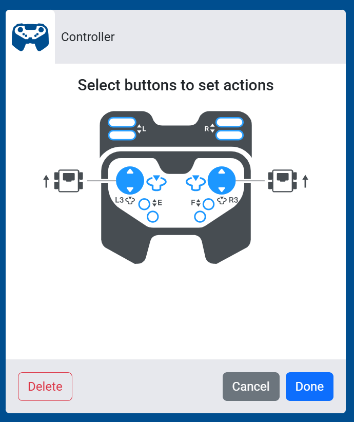

Tank Drive#
The left joystick controls the left side of the Drivetrain, and the right joystick controls the right side, independently.
Screenshot of the Select buttons to set actions screen, showing the left and right joysticks each set to control their own side of the Drivetrain.
