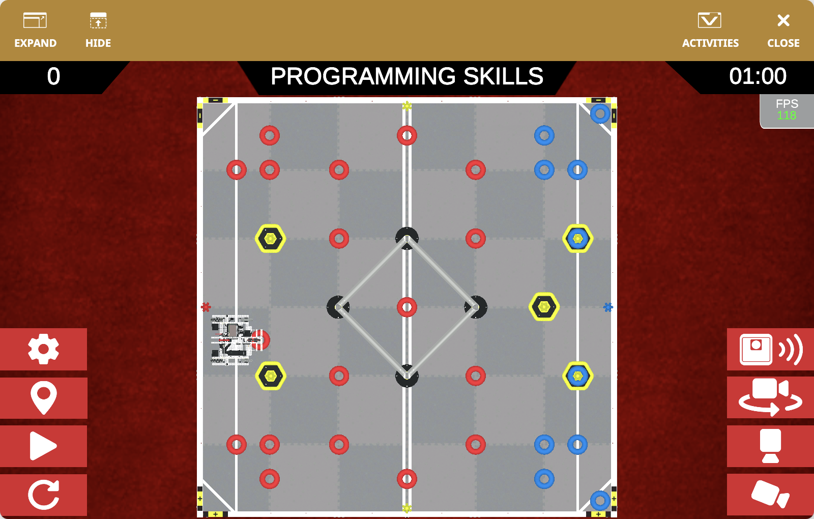

The VEXcode VR Playground window showing the V5 24-25 High Stakes Playground. It shows the Axel Robot manipulating Rings with an arm and pusher in a GPS-enabled competition field.
The V5 24-25 High Stakes Playground lets you try to get the most points in the Programming Skills challenge for the season.
