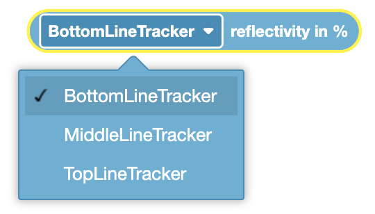

Line Tracker Sensing#
Line Tracker Reflectivity#
The Line Tracker Reflectivity block is used to report the amount of light reflected using the Line Tracker sensor.
The Line Tracker Reflectivity block will report a range from 0% to 100%. Surfaces with lighter colors have higher reflectivity values, while darker surfaces have lower reflectivity values.
    ([BottomLineTracker v] reflectivity in %)
Choose which Line Tracker Sensor to use.

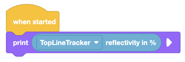

In this example, the robot will print the current reflectivity with the Top Line Tracker Sensor.
    when started
    print ([BottomLineTracker v] reflectivity in %) ▶
