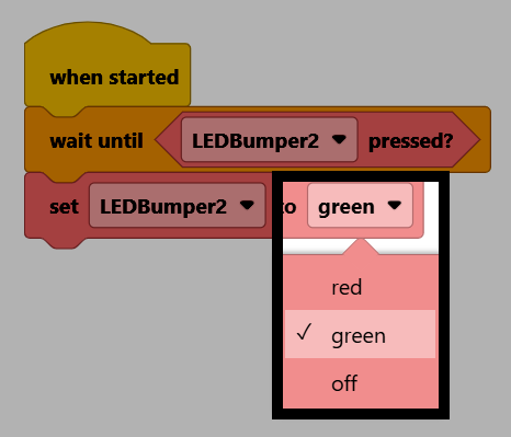

  1. Attach a Set Bumper color block below the wait until block.
The Set Bumper color block, attached below wait until.#
cuando inicie :: hat events
esperar hasta <¿[LEDBumper2 v] presionado? :: custom-led>
establecer [LEDBumper2 v] a [rojo v] :: custom-led
  1. Change the color parameter to green.
Screenshot of the finished project, with the Set Bumper color block's dropdown open, showing red, green, and off options, and green selected.
