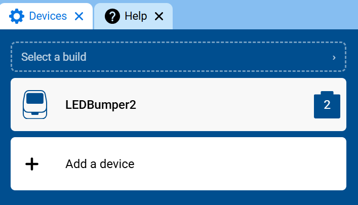

  1. Make sure your robot has an LED Bumper connected. See Configuring Devices if you haven’t added one yet.
Screenshot of the Devices tab, showing LEDBumper2 in the list of devices.

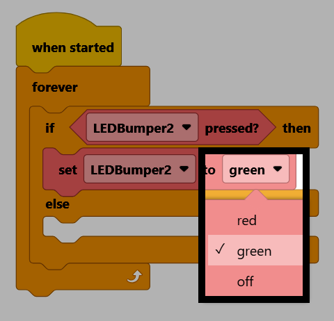

  1. Change the color parameter to green.
Screenshot of the project, with the if branch's Set Bumper color block's dropdown open, showing red, green, and off options, and green selected.

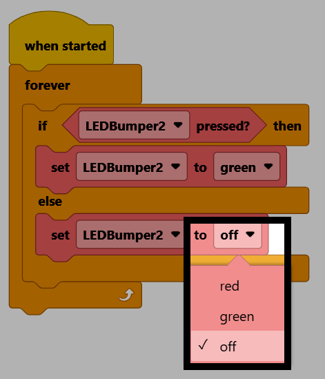

  1. Change the color parameter to off.
Screenshot of the finished project, with the else branch's Set Bumper color block's dropdown open, showing red, green, and off options, and off selected.
