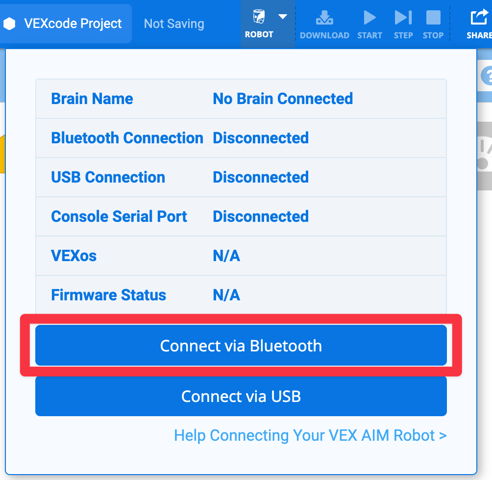

  1. Select Connect next to Bluetooth under Wireless Connection.
Screenshot of the Connect menu, showing the Wired Connection and Wireless Connection sections, with the Connect button next to Bluetooth highlighted.
