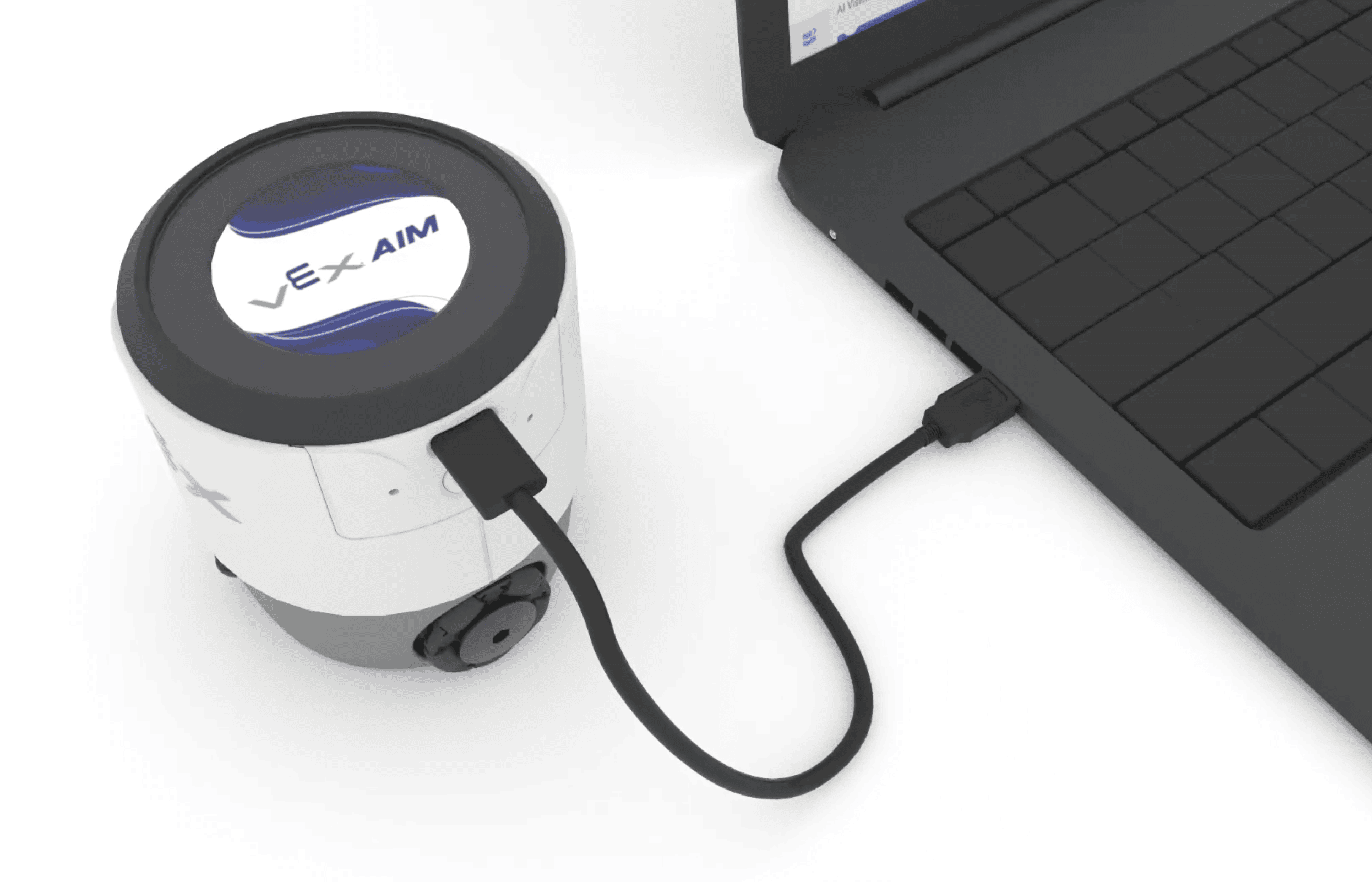

  1. Connect your robot to your computer with a USB-C cable. The robot will turn on by itself.
AIM Robot to the left of a laptop with a cable connecting the two electronics.

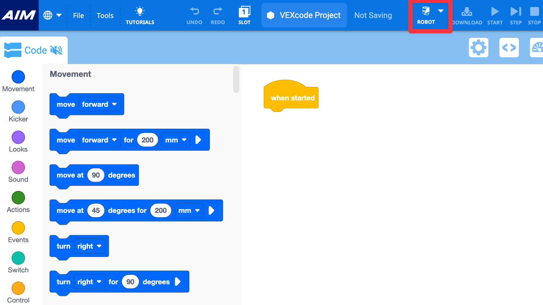

  1. Select the Connect button at the top-right of VEXcode.
Screenshot of the VEXcode AIM toolbar, with the Connect button highlighted.

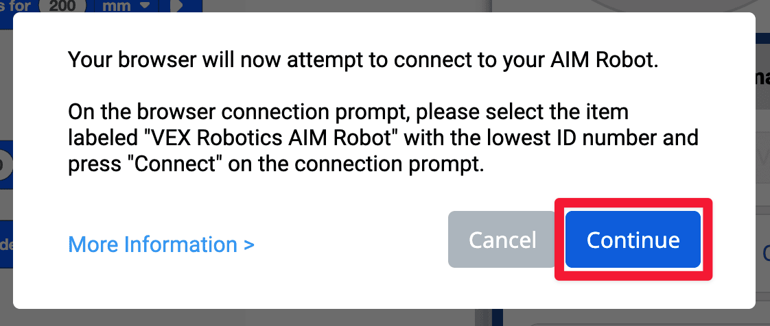

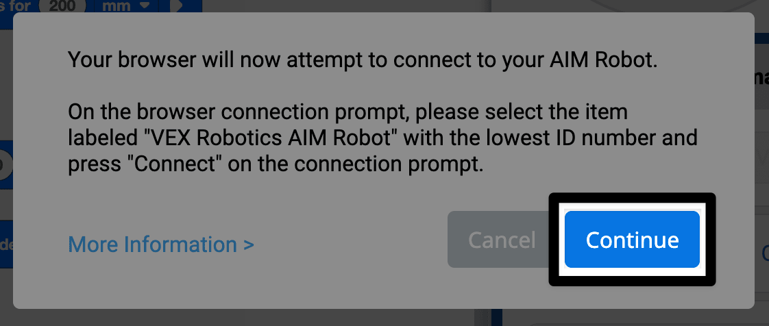

  1. Select Connect next to USB under Wired Connection.
Screenshot of the Connect menu, showing the Wired Connection and Wireless Connection sections, with the Connect button next to USB highlighted.

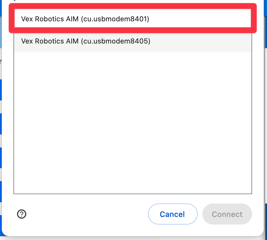

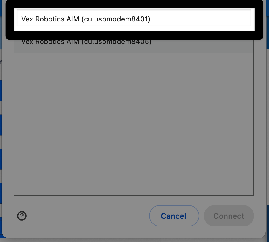

  1. Your browser will ask which serial port to connect to. Select the lower-numbered Vex Robotics AIM entry.
Screenshot of the serial port dialog on macOS, with the lower-numbered Vex Robotics AIM entry highlighted.

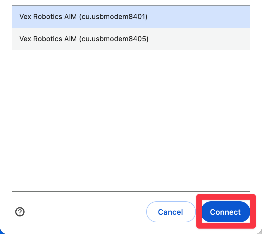

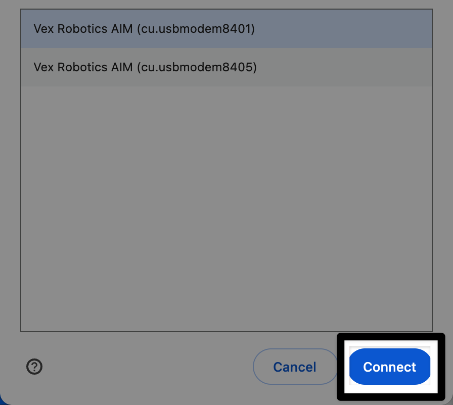

  1. Select Connect.
Screenshot of the serial port dialog on macOS, with the lower-numbered entry selected and the Connect button highlighted.
