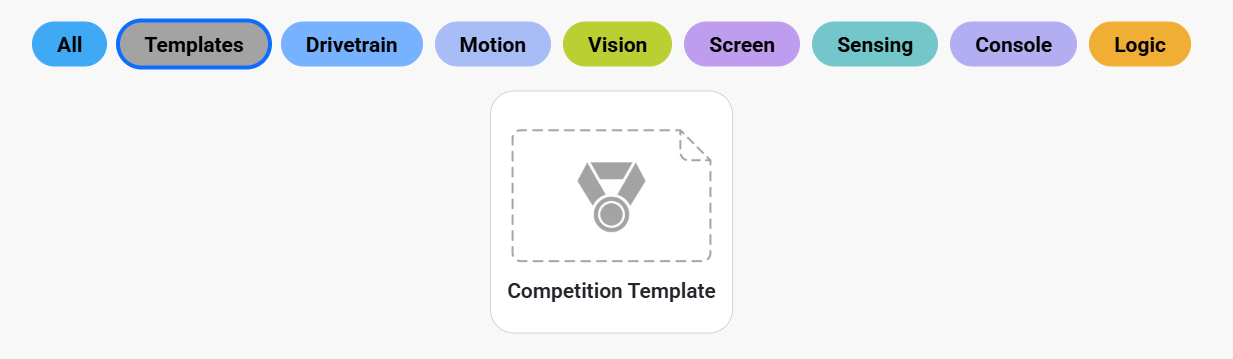

From the Open Examples page, filtering by Templates shows the Competition Template, which you’ll need if you’re building a project for a VEX V5 Robotics Competition, VEX U Robotics Competition, or VEX AI Robotics Competition.
Screenshot of the Open Examples page, with the Templates filter highlighted, showing the Competition Template.

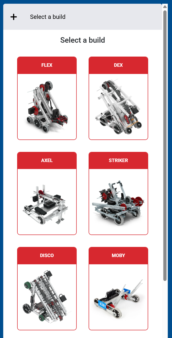

Choose Your Robot Build#
Select the robot build you are using.
Screenshot of the Select a build screen, showing a grid of available robot builds.

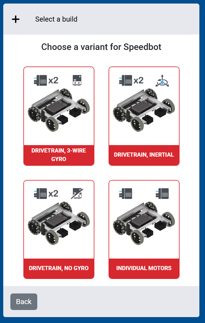

Choose a Build Variant#
If your build has different versions, select which version you’re using.
Screenshot of the Choose a variant for Speedbot screen, showing the Drivetrain, 3-Wire Gyro, Drivetrain, Inertial, Drivetrain, No Gyro, and Individual Motors options.

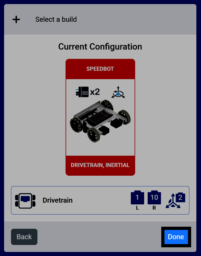

Confirm the Configuration#
VEXcode will show you all of the devices used with the build and what ports they’re connected to. Select Done to add this configuration to your project.
Screenshot of the Current Configuration screen for the Speedbot, Drivetrain, Inertial build, with the Done button highlighted.

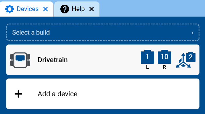

View the Configured Devices#
Those devices will now appear, configured in the Devices menu, ready to code with.
Screenshot of the Devices tab, showing Drivetrain in the list of devices.
