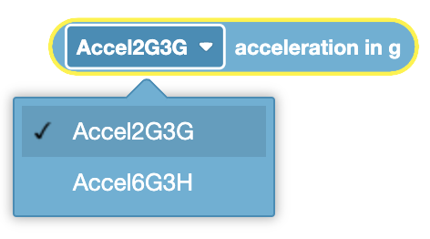

The Accelerometer Acceleration block reports a range from -2.0 G to 2.0 G or -6.0 G to 6.0 G depending upon the jumper setting on the Analog Accelerometer.
Choose which Accelerometer to use.
