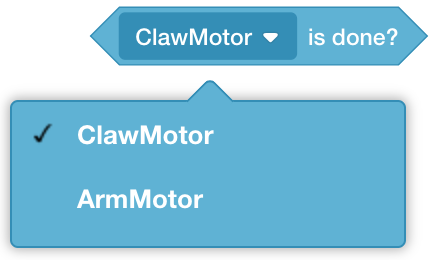

Motor is Done?#
The Motor is Done? block is used to report if the selected V5 Smart Motor or Motor Group has completed its movement.
  <[ClawMotor v] is done?>
The Motor is Done? block reports True when the selected Motor or Motor Group has completed its movement.
The Motor is Done? block reports False when the selected Motor or Motor Group is still moving.
Choose which Motor or Motor Group to use.

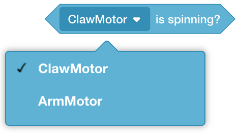

Motor is Spinning?#
The Motor is Spinning? block is used to report if the selected V5 Smart Motor or Motor Group is currently moving.
  <[ClawMotor v] is spinning?>
The Motor is Spinning? block reports True when the selected Motor or Motor Group is moving.
The Motor is Spinning? block reports False when the selected Motor or Motor Group is not moving.

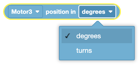

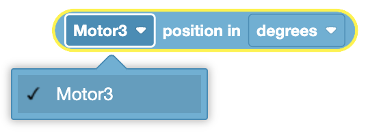

Position of Motor#
The Position of Motor block is used to report the distance an V5 Smart Motor or the first motor of a Motor Group has traveled.
  ([Motor3 v] position in [degrees v])
Diagram illustrating motor position and sensing parameters for V5 Smart Motor operations.
Choose the units to report in, degrees or turns.
Diagram illustrating motor position units and their corresponding values in V5 Brain Sensing.
In this example, the Motor will spin forward for 1 second before its current position is printed on the Brain’s screen.

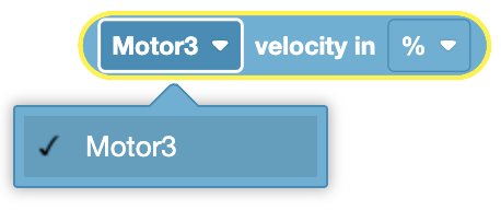

Velocity of Motor#
The Velocity of Motor block is used to report the current velocity of an V5 Smart Motor or the first motor of a Motor Group.
  ([Motor3 v] velocity in [% v])
The Velocity of Motor block reports a range from -100% to 100% or -600rpm to 600rpm.

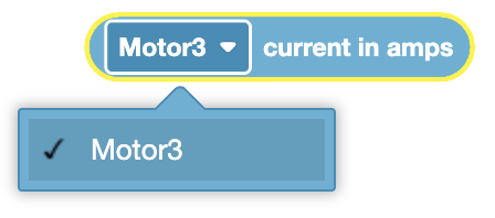

Current of Motor#
The Current of Motor block is used to report the amount of current a V5 Smart Motor or Motor Group is drawing in amperes (amps).
  ([Motor3 v] current in amps)

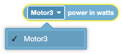

Power of Motor#
The Power of Motor block is used to report the amount of power output a V5 Smart Motor or the first motor of a Motor Group is currently generating.
  ([Motor3 v] power in watts)

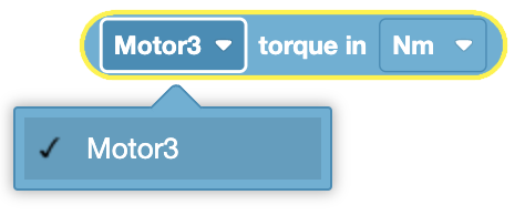

Torque of Motor#
The Torque of Motor block is used to report the amount of torque (rotational force) a V5 Smart Motor or the first motor of a Motor Group is currently using.
  ([Motor3 v] torque in [Nm v])
The Torque of Motor block reports a range from 0.0 to 18.6 inch-pounds (InLB) or 0.0 to 2.1 Newton-meters (Nm).
Diagram illustrating motor torque parameters for V5 Smart Motors, including torque, power, and efficiency metrics.

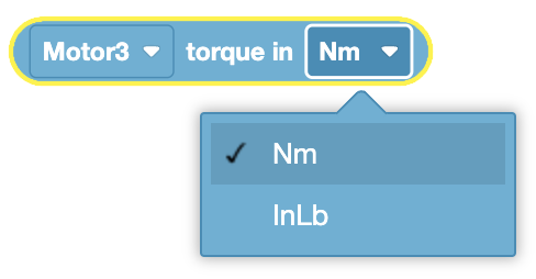

Choose the units to report in, Nm or InLb.
Diagram illustrating motor torque measurement units for V5 Smart Motors, including InLB and Nm.

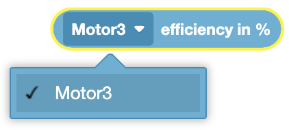

Efficiency of Motor#
The Efficiency of Motor block is used to report the efficiency of a V5 Smart Motor or the first motor of a Motor Group.
  ([Motor3 v] efficiency in %)
The Efficiency of Motor block reports a range from 0% to 100%, determined by the value of the power (in watts) the motor is using (input), versus the amount of power (in watts) the motor is providing (output).
An V5 Smart Motor or Motor Group typically reaches a maximum efficiency of 65% under normal use cases.

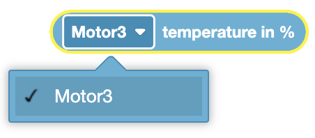

Temperature of Motor#
The Temperature of Motor block is used to report the temperature of a V5 Smart Motor or the first motor of a Motor Group.
  ([Motor3 v] temperature in %)
The Temperature of Motor block reports a range from 0% to 100%.
