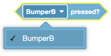

Bumper Pressed#
The Bumper Pressed block is used to report if the Bumper Switch is pressed.
  <[BumperB v] pressed?>
The Bumper Pressed block reports True when the selected Bumper Switch is pressed.
The Bumper Pressed block reports False when the selected Bumper Switch is not pressed.
Choose which Bumper Switch to use.
