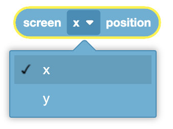

Screen Position#
The Screen Position block is used to report the location of the last detected touch on the V5 Brain’s touchscreen.
  (screen [x v] position)
Choose what axis to report: x or y.
