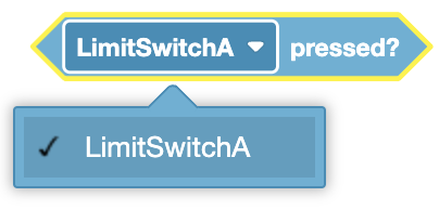

The Limit Pressed block is used to report if the Limit Switch is pressed.
  <[LimitSwitchA v] pressed?>
The Limit Pressed block reports True when the selected Limit Switch is pressed.
The Limit Pressed block reports False when the selected Limit Switch is not pressed.
Choose which Limit Switch to use.
