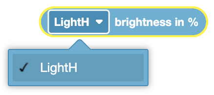

The Light Sensor Brightness block is used to report the amount of light detected by the Light Sensor.
  ([LightH v] brightness in %)
Choose which Light Sensor to use.
