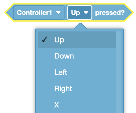

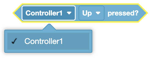

Controller Pressed#
The Controller Pressed block is used to report if a button on the V5 Controller is pressed.
<[Controller1 v] [▲ v] pressed?>
The Controller Pressed block reports True when the selected Controller button is pressed.
The Controller Pressed block reports False when the selected Controller button is not pressed.
In this example, the Brain will print a message on its screen the first time the X button on the controller is pressed.

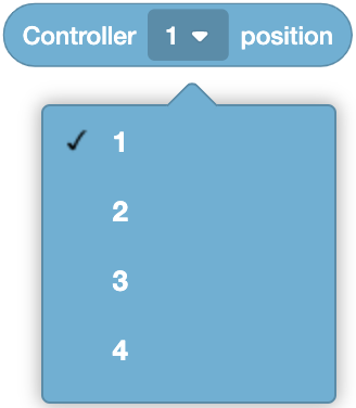

The Position of Controller block is used to report the position of a joystick on the V5 Controller along an axis.
  (Controller [1 v] position)
The Position of Controller block reports a range from -100 to 100.
The Position of Controller block reports 0 when the joystick axis is centered.
Choose the joystick’s axis.

In this example, the Brain will print the 3rd axis of the V5 Controller’s joysticks.
  when started
  print (Controller [3 v] position) on [Brain v] ◀ and set cursor to next row
