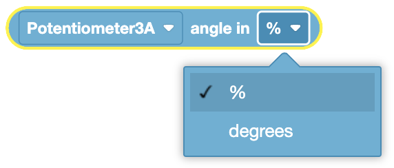

Choose which unit to report in: percent (%) or degrees.
Potentiometer angle measurement display showing angular position in degrees or percent for V5 Brain.
