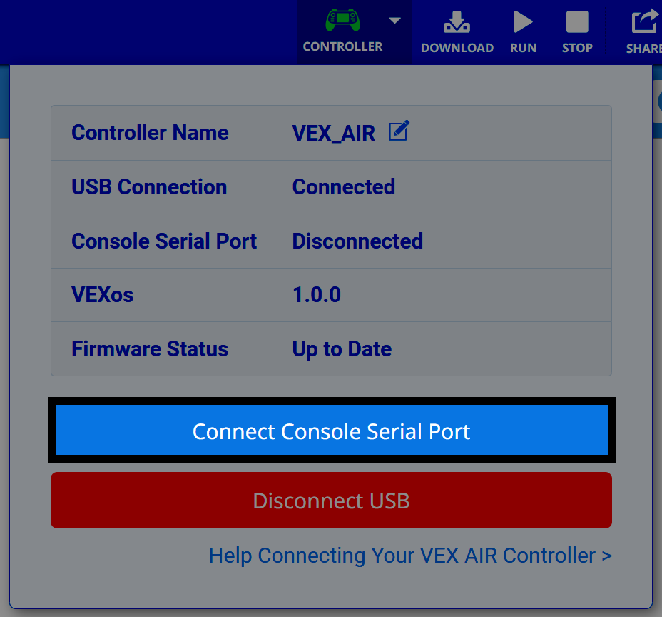

Select Connect Console Serial Port#
Within the Controller menu, select Connect Console Serial Port.

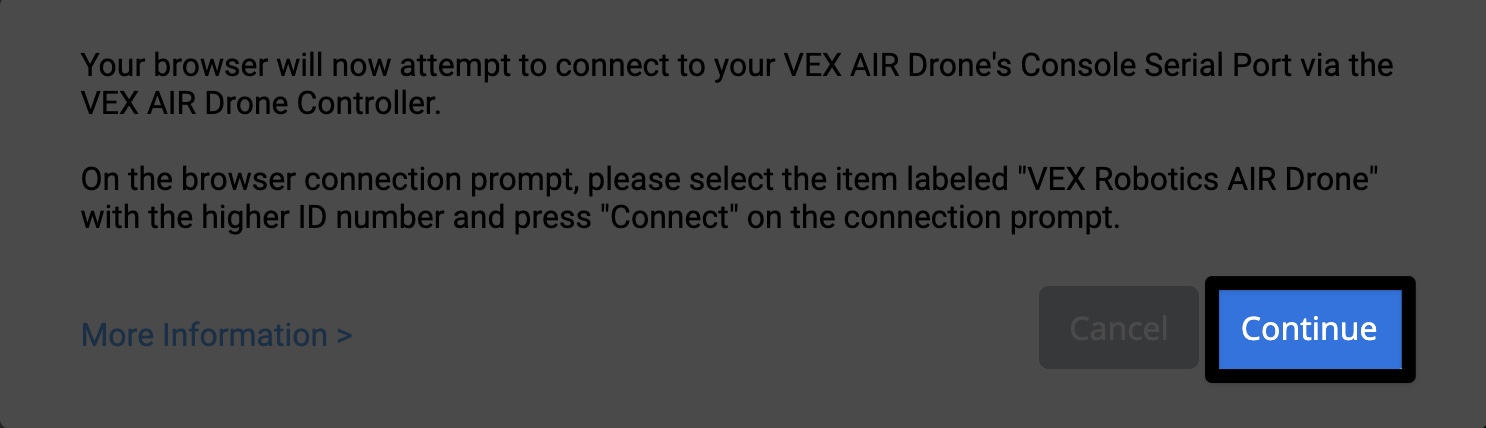

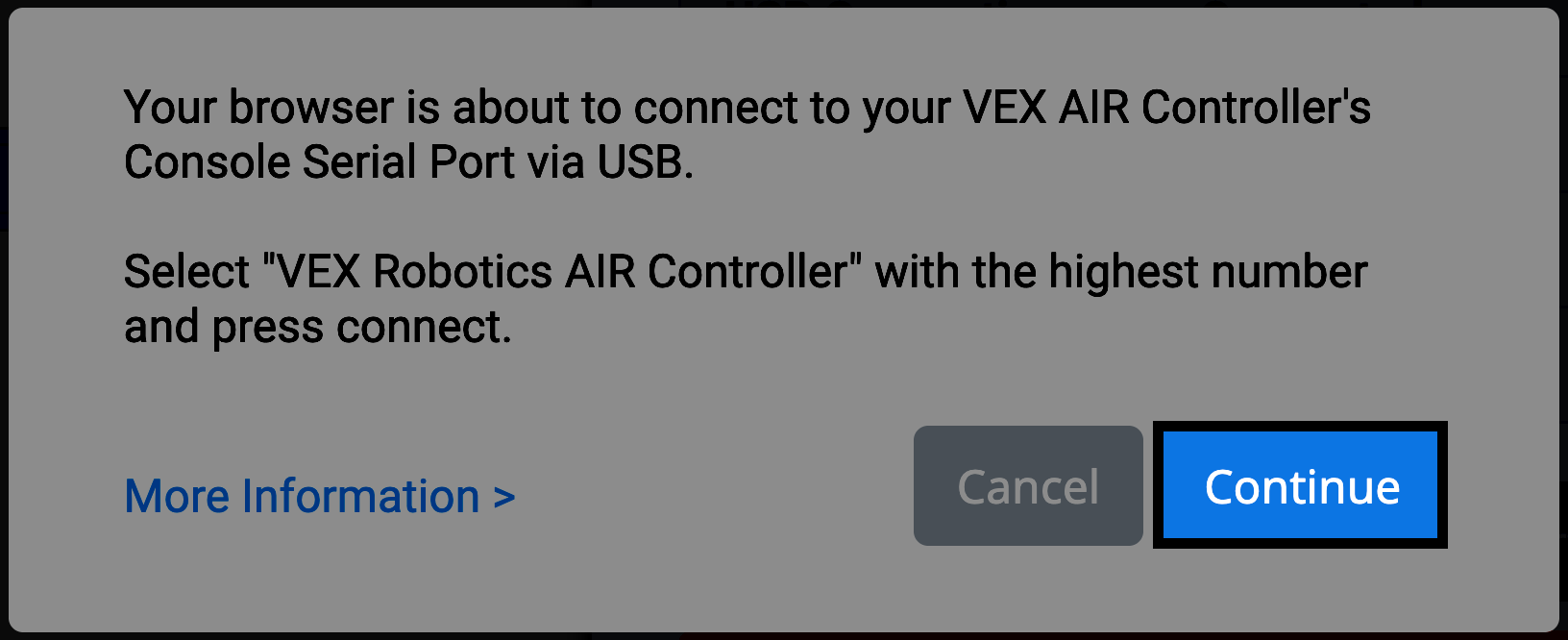

Select Continue in the prompt#

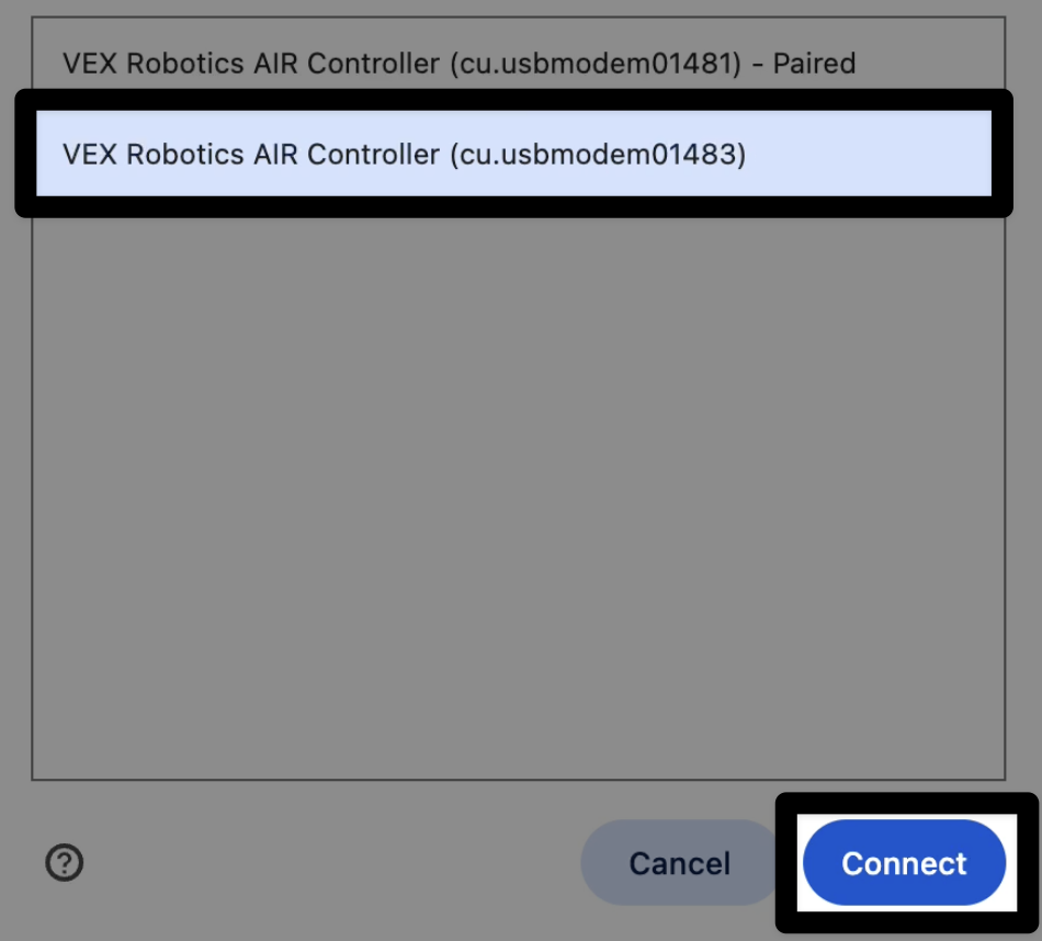

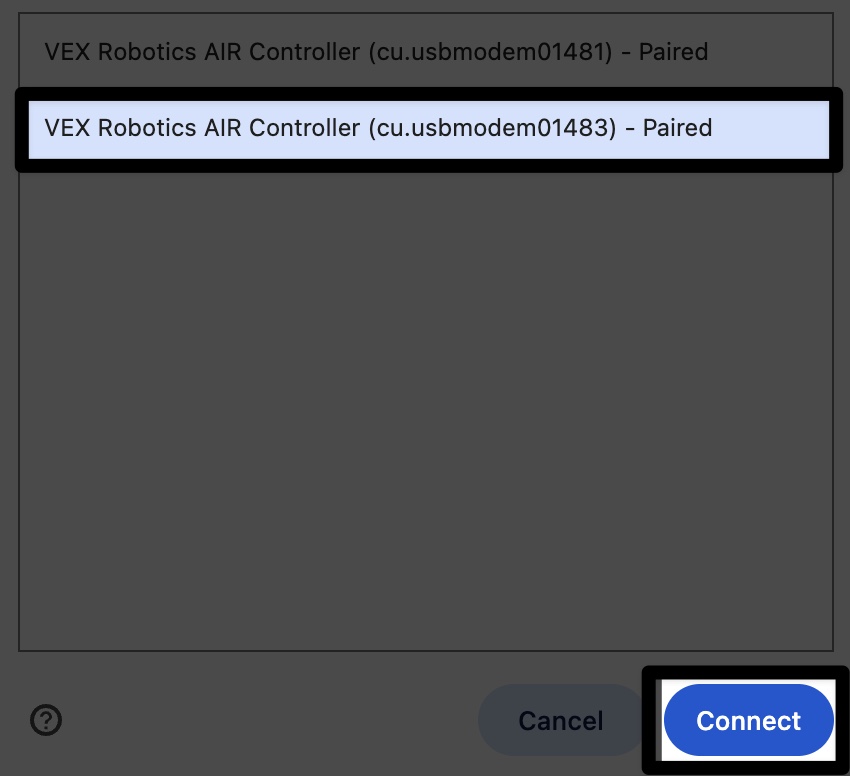

Select the correct ID number#
Select the option with the HIGHEST ID number.

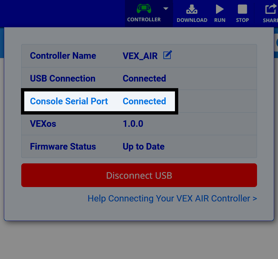

Check the connection status#
Once connected, the Console Serial Port connection status in the Controller menu will say Connected.
