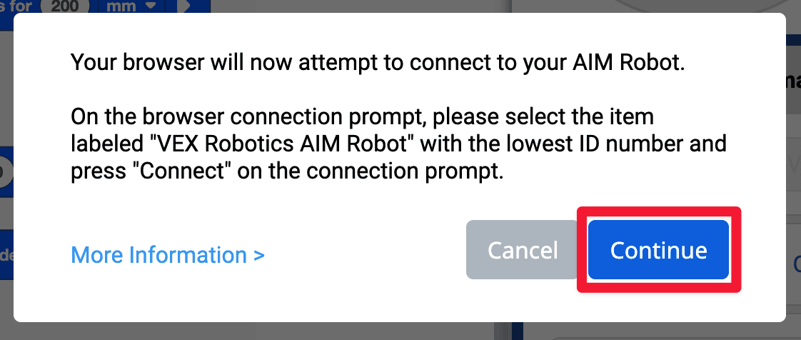

Follow the device prompts#
A prompt reads Your browser is about to connect to your VEX AIR Controller via USB, and instructs to select the VEX Robotics AIR Controller with the lowest number and press Connect when prompted. The Continue button in the lower right corner is highlighted.

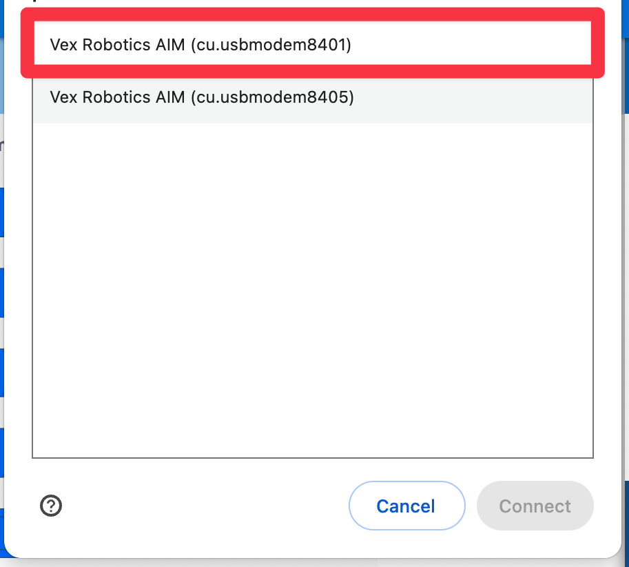

Pick the right connection option#
Select the option with the LOWEST ID number from the list of robots available.
A prompt reads codeair.vex.com wants to connect to a serial port, and the first option with the lowest ID number is highlighted, indicating what to select.

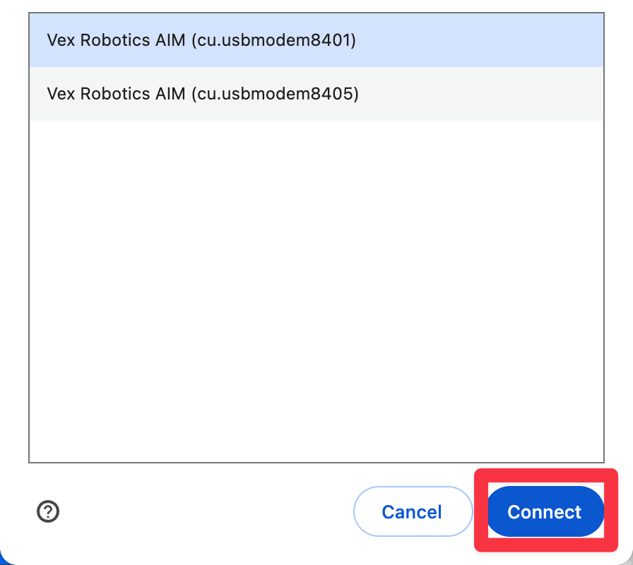

Finalize your connection#
The same image as above, now with the Connect button in the lower right corner highlighted.
