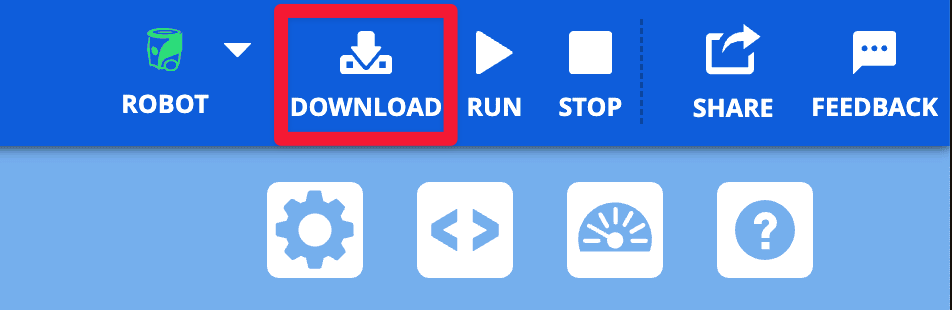

Downloading a project#

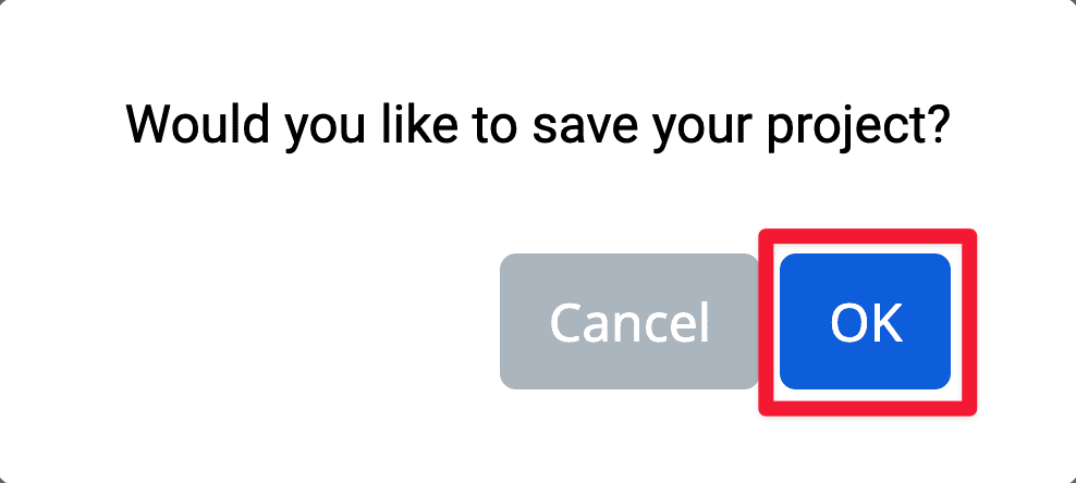

Save if needed#
If you have not yet saved your project, you will be prompted to save it. Select Yes to save your project to your device.
Wait for the Download Progress Bar#

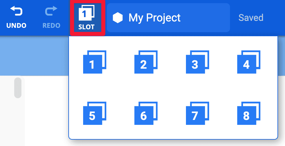

Note: VEXcode AIR projects will download to Slot 1 on the controller by default. To change the slot number you download a project to, select the Slot icon and choose from the available slots.

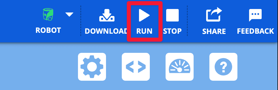

Running a project#
Once a project is downloaded to the controller, you can run the project either in VEXcode AIR or on the controller.

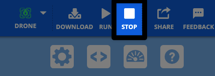

Stopping a project#
You can stop a project at any time using either VEXcode AIR or the controller.
Press Land to stop the project and land the drone#
If the drone is flying when the Takeoff button is pressed, you will be prompted to land the drone to stop the project.
