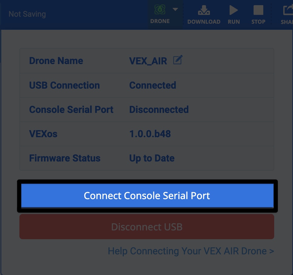

Select Connect Console Serial Port#
Within the Controller menu, select Connect Console Serial Port.

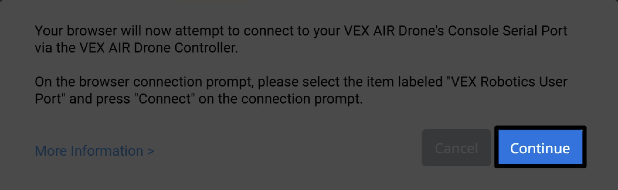

Select Continue in the prompt#

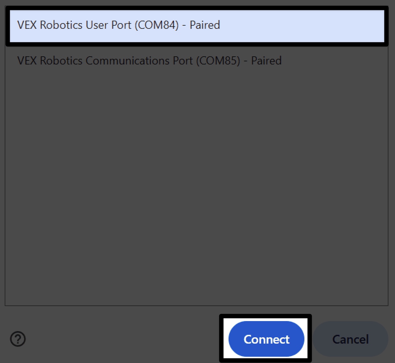

Select the correct port#
Select the option that says User Port.

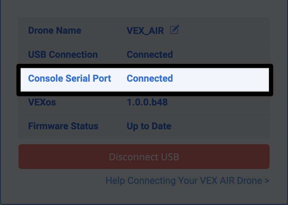

Check the connection status#
Once connected, the Console Serial Port connection status in the Controller menu will say Connected.
