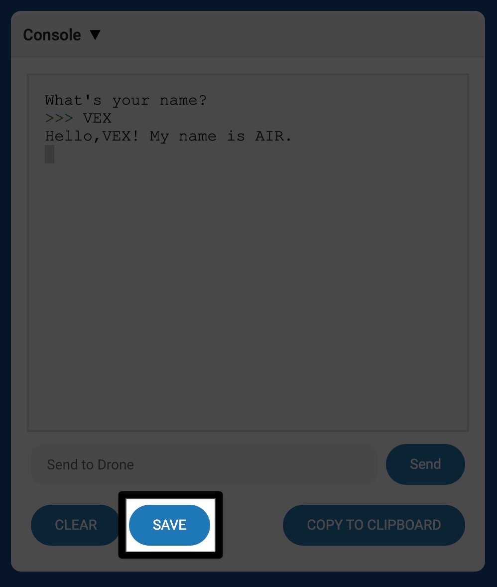

Save from the Console#
Select SAVE to save all Console information as a .txt file.
Console window displaying text output including a prompt and response, with the Save button highlighted below the console.

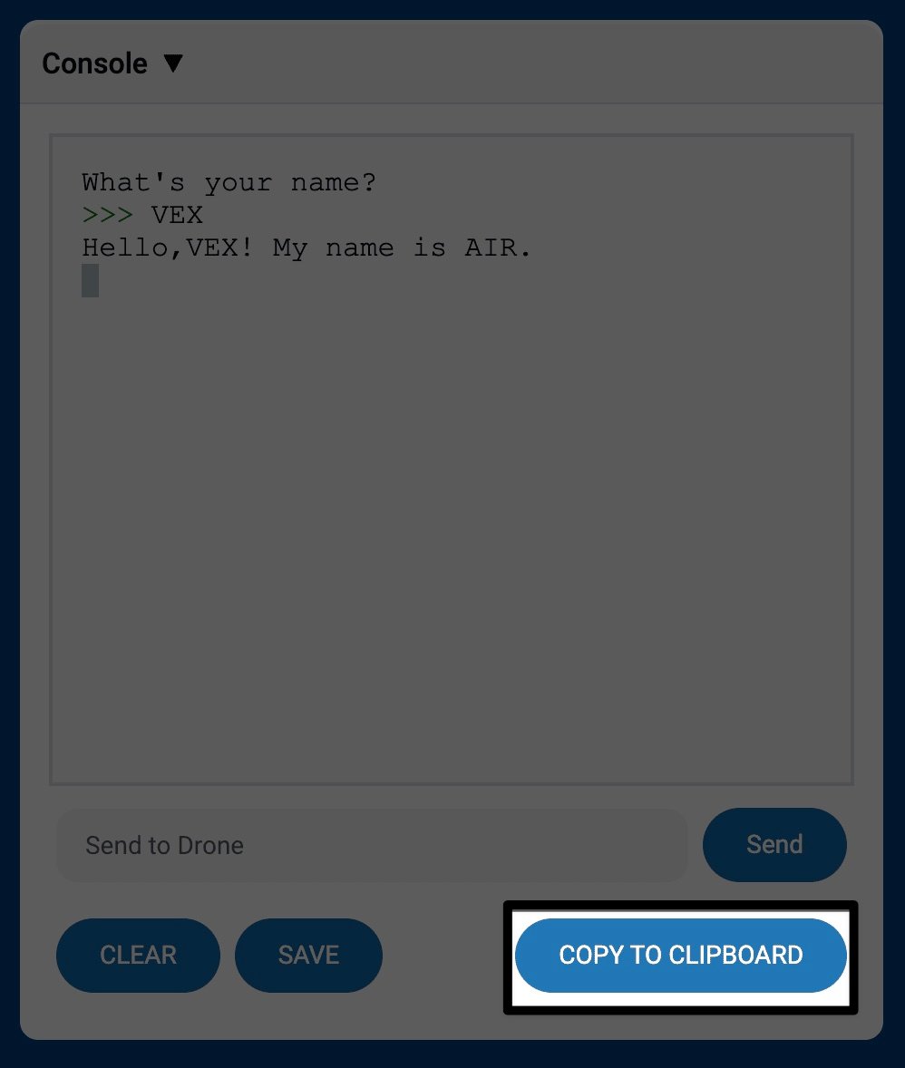

Copy from the Console#
Select COPY TO CLIPBOARD to save all Console information to your clipboard.
Console window displaying text output, with the Copy to Clipboard button highlighted below the console.
