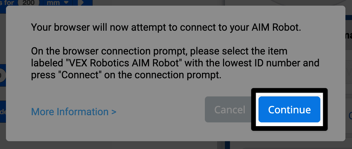

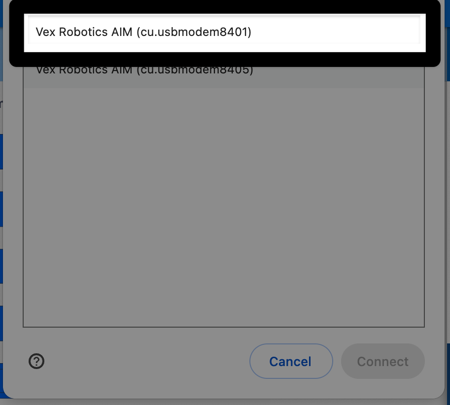

  1. Your browser will ask which serial port to connect to. Select the lower-numbered Vex Robotics AIM entry.
Screenshot of the serial port dialog on macOS, with the lower-numbered Vex Robotics AIM entry highlighted.

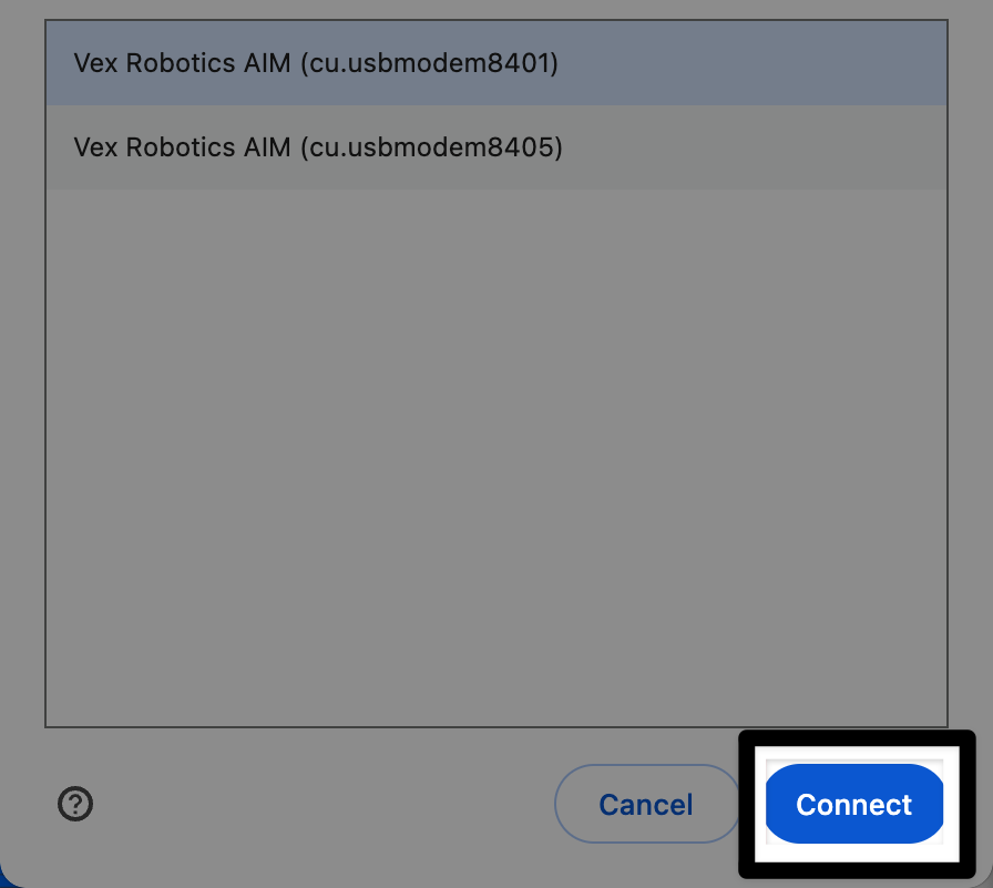

  1. Select Connect.
Screenshot of the serial port dialog on macOS, with the lower-numbered entry selected and the Connect button highlighted.
