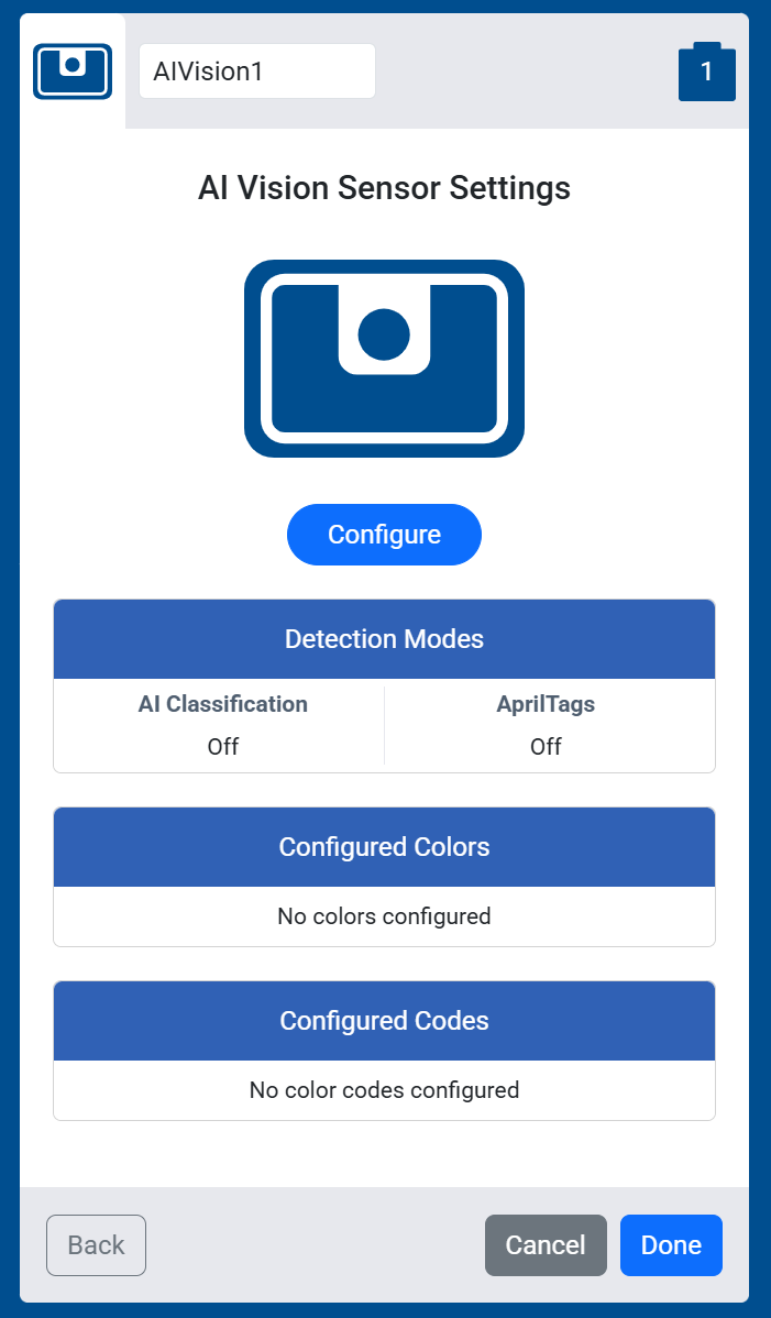

Configure Additional Settings#
Some more complex sensors, like the AI Vision Sensor, will have additional settings to configure. For example, the AI Vision Sensor lets you turn on Detection Modes and configure Color Signatures and Color Codes.
Screenshot of the AI Vision Sensor Settings screen, showing Detection Modes, Configured Colors, and Configured Codes.

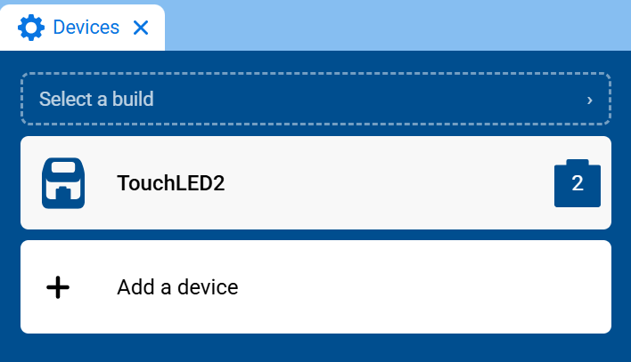

View the Sensor in Your Devices List#
The sensor will now appear in your list of devices, and its blocks will be added to your toolbox.
Screenshot of the Devices tab, showing TouchLED2 in the list of devices.
