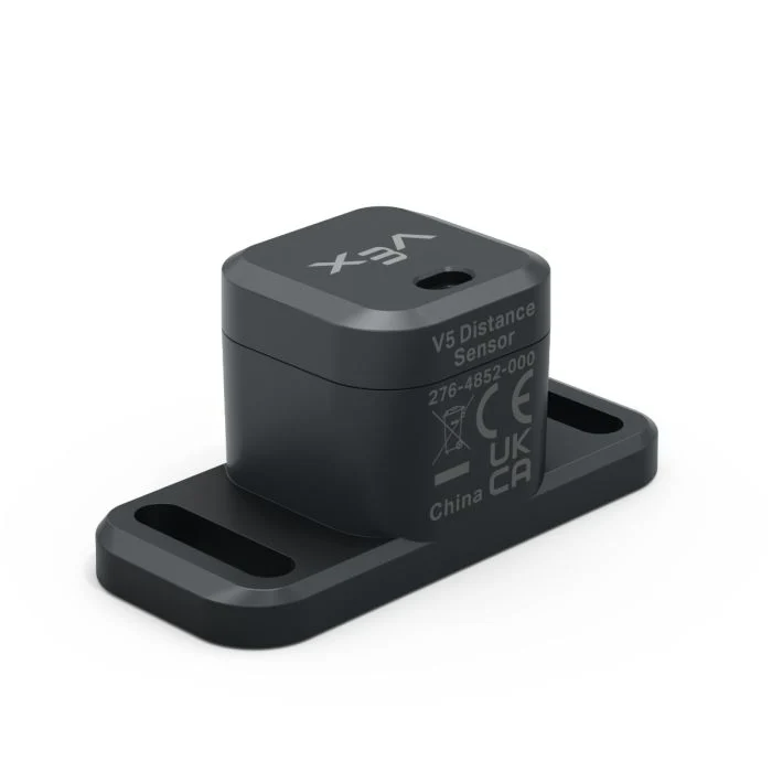

The Distance Sensor can detect whether an object is in front of the sensor and return how far away that object is. It can also report the detected object’s relative velocity and estimate whether the object is small, medium, or large.
The Distance Sensor operates over a range of 20 mm to 2000 mm.
Below 200mm, accuracy is approximately ±15mm. Above 200mm, accuracy improves to about 5%.
The Distance Sensor uses a Class 1 laser. Detection is directed straight ahead and is classroom-safe.
The Distance Sensor.
